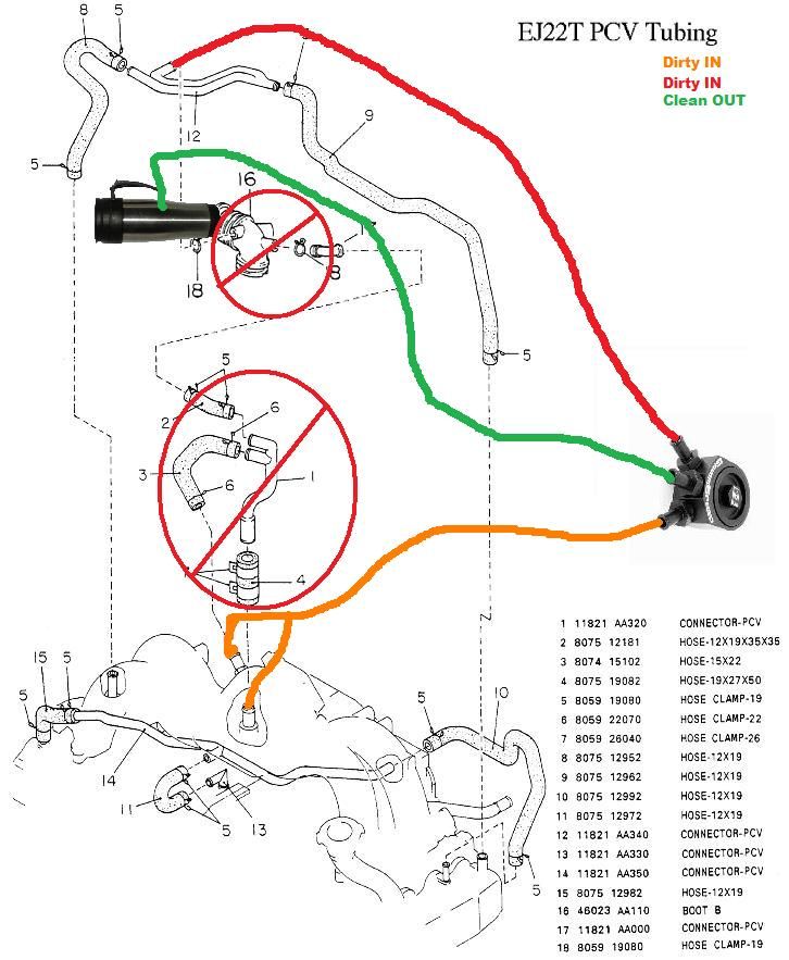

I need to map out my entire pcv system, I am hoping to replace that 90 elbow used for some of the PCV system and the BPV with just a solid 90* silicone elbow and route all the PCV stuff through my Grimmspeed AOS. I think it can be done, and it would clean up the needlessly convoluted PCV system this car has...seriously I think all the oil blow by is created by the piss poor factory PCV routing...it's just straight illogical.
does anyone have a chart of the pcv setup??

I am basically just going to replace that upper hose with the AOS system, keep the PCV valve itself and run that one hose from the manifold to my "coffee can" to get the live vacuum that was at the 90* Should wok fine
Posts: 27943
Re: Xise's 1993 Legacy Turbo
Which upper hose are you talking about? The one from the back of the block? That needs to be tied into both the PCV and pre turbo intake piping.
If you can draw up a little diagram, that would help to make sure that things don't get messed up.

Exactly it is tied to the crank case breather tubes one on each head and connecting to the 90 elbow. The BPV is going to be replaced with a bov and the AOS piped into those breather tubes , I was then going to route the other small connector into the "coffee can" directly before the 90* so everything stay in the same flow with just an AOS routed in between the drivers/pass. cylinder heads.
Posts: 27943
I'm not sure I follow you 100% on the routing....like I said, if you could draw a diagram in paint or something, that'd be great. I would definitely route the rear vent to the AOS and then to the intake piping & PCV.
The breather hoses on the heads primarily bring fresh air into the block so they really don't need to run through the AOS. I put a simple foam filter material in the line to help coalesce any oil vapor. Then it'll just drop down into the heads.

Right they are just crank case breathers, I am actually simplifying it a bit
I believe this should work without any issues
Posts: 27943
There is no dirty crankcase emissions coming out of the PCV valve. The PCV valve is an inlet, not outlet.
You need to take that green line and also run it into the PCV valve AND the coffee cup.
The heads primarily draw fresh air in, so your red "dirty in" isn't really accurate. I'd really suggest just leaving those lines alone. If you want to do anything, just put some foam from a lawn mower air filter in the lines, like this.

Well all I know is that I am getting oil residue all inside the inlet of the turbo and also in the charge tube right before the throttle body, I want to be able to catch the oil before the turbo intlet.
I understand what you are saying, I am trying to replace that 90 elbow because it is cracked and causing a leak, I'd rather not buy a new one as that samco one is out of my price range right now. So I was going to use a plain old silicone elbow and just route everything that needed to be part of the intake to the coffee can.
believe me if I had the money, i'd save myself the hassle, get the apexi power intake, the samco V1 90 elbow, and a v1 sti intercooler and call it a day.....alas the struggles of a broke man lol
thanks for your advice though, that little tidbit about the head breather pipes ...I really should have known that it was an intake and not a vent, the other side is the vent and is routed under the intake manifold.....derp

with my setup
the center goes to the intake.
the right side gets split and goes to both valve covers
the left goes to hose #4 in your diagram.

So your setup is exactly how I had mine in the first diagram I made.....

Yes, but mine goes in the #4 hose directly. It doesn't split like u have it.

The hose routing is split from the factory on the 22T one the other end goes right into the intake...which is where the AOS lets it out anyway.
