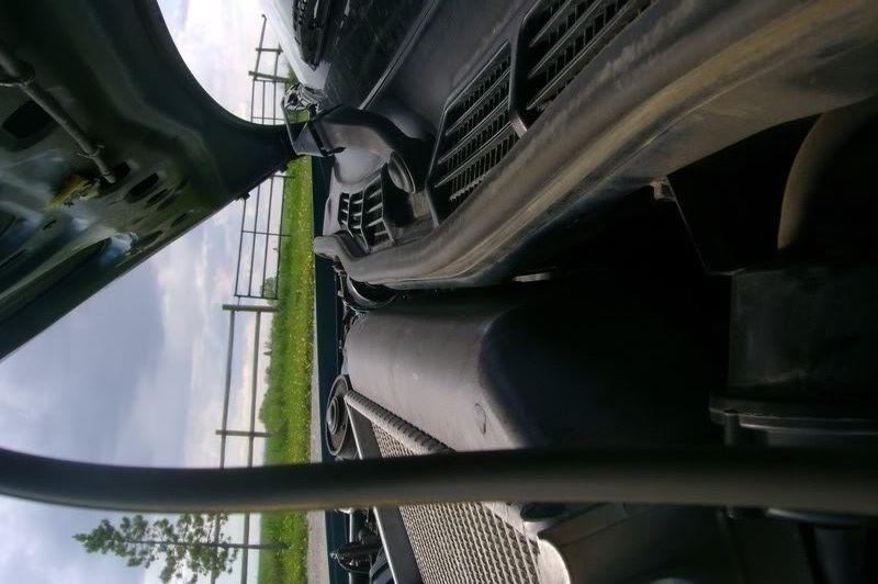

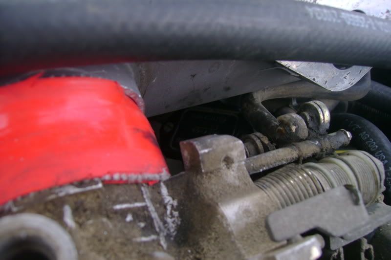

Well here Are the pics and videos.
Wingless, This is where i moved the ignitor for the WRX TMIC, i grounded it with the Starter.
Squeezed!
Its not pretty but it works!
Squeezed!

Looks good very good.
Two things though, I would put some solder around the straight metal pipe and the 90* pipe that you're using to route to your bypass valve. Just to make sure it isn't leaking at all.
Secondly, I'd try to find a way to put a 90* bend on the end of the rubber hose after the bypass valve. It looks like it's sort of folds over itself and I wouldn't be particularly keen on it dipping so low next to the turbo.
Other than that, it looks great man!
