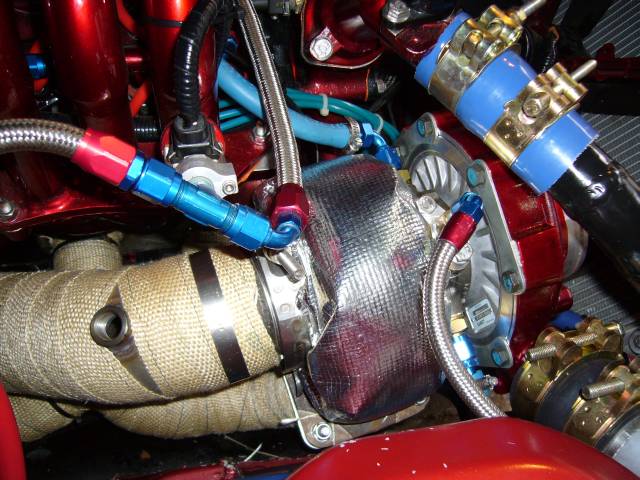

Looking at the turbo and this wrap I don't see how you wrap the actual turbo itself. I gotta see pictures of this.
Are you talking about this kind of turbo wrap? Not the stuff I bought for the pipes?

^^^ That's much nicer than what I did, LOL. I just used some of the same tape I ordered for the downpipe. It doesn't cover the whole thing, but it still helps keep the temps down somewhat:
