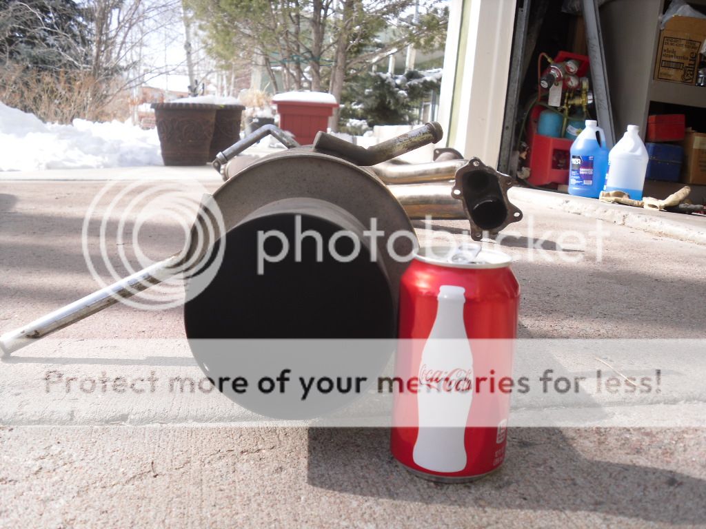

Got this for $300. 3in turbo-back exhaust with a divorced downpipe. Not too sure about the brands. The catback is the ebay SRS which i've heard good reviews. As for the downpipe, the guy said something about "BPM" and it was like austrailian spec... he said it was good and that he had it on his vf43 and loved it.
Anyways, time for some pics soo strap in!

That exhaust is freaking awesome!!! Nice find bud!

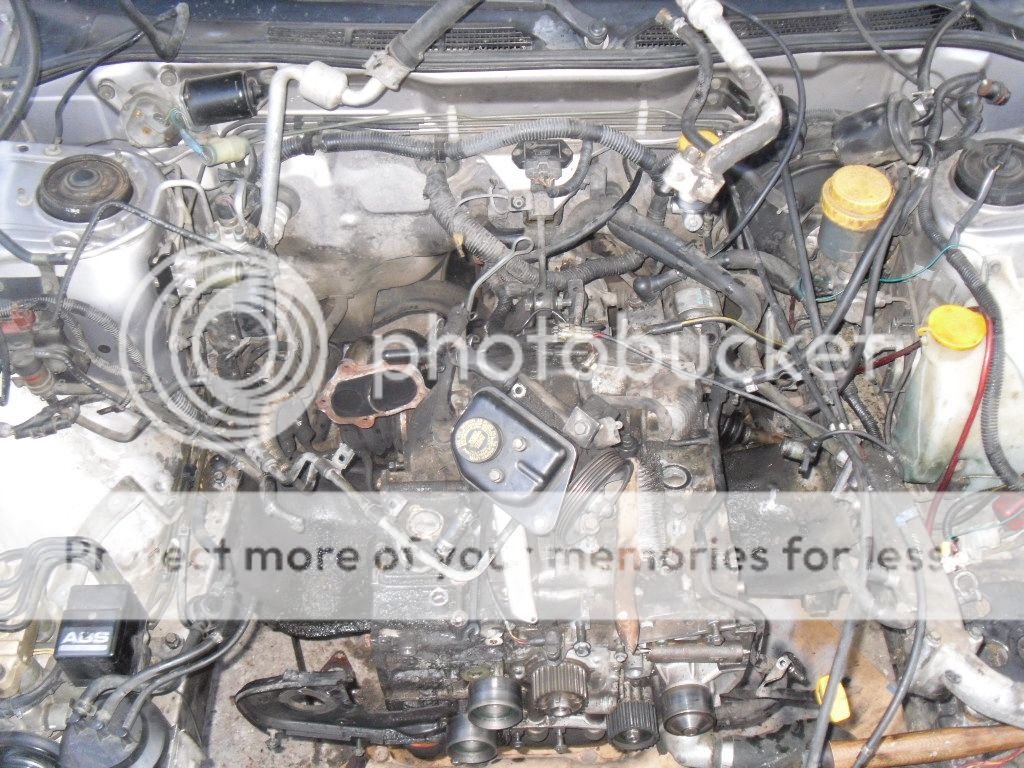

Ok, so I'm gunna attempt to pull the heads off soon to get em to a machine shop and get those exhaust valves fixed. Any tips or anything i should know before i have at it? I just take the intake mani off and all the accessories like alternator, a/c, resevoirs, etc., right? what about all the belts and tighteners off the front, do those have to come off?
Gunna try and get em off thrusday-sunday this week, think thats enough time?
anything will help, thanks!
EDIT: Do the valve covers AND camshafts come off with the heads altogether?
Chris
1992 SS Liquid Silver Metallic 5MT AWD, 3in TBE, TD04, 06 TMIC, MBC, Coffee Cup Mod, 04 STi Struts
Re: 92ColoradoTurbo's build/help
On Single cam heads you can pull them without taking the valve covers off. You do have to remove the cam gears and the lower left t belt pulley to remove the back timing covers. there's also a 10mm bolt that is on the drivers side head for the oil dipstick, and i "think" there's a 10mm bolt on top for the water lines. Pull the motor. If you're taking the heads in to get head work, take the cams off and pull the lifters or rocker assembly, it'll make it easier for the machinist.

cj91legss wrote:Pull the motor. If you're taking the heads in to get head work, take the cams off and pull the lifters or rocker assembly, it'll make it easier for the machinist.
Whoa... I thought I didn't have to pull the engine out to get the heads off.
And I'll remove the cams and rockers so i just send in head with the valves and valve springs in?
Is shooting for a goal of "having this all back together and running by the end of next month" a plausible goal for a first timer? lol
Chris
Posts: 27930
Have you downloaded the factory service manual from me? If not, do that and read through the procedure on pulling the heads. It gives you pretty detailed info.

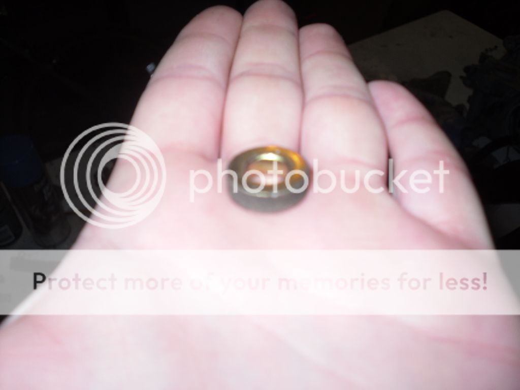

Quick question! Where do these go?... I think they fell off from my intake mani when i was taking the fuel rails off of it. (there are four of them)
