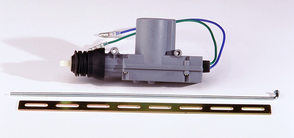

I'm assuming you mean, you want to make it so when you disarm/arm the alarm it unlocks/locks the power locks.....this correct?
If so, you will need a door lock servo actuator. You can not wire into the stock electric door locks.
Here is a picture of what I'm talking about http://pix.crutchfield.com/lifestyle/2000/h514DS2.jpeg
You'd just mount it in the door, then connect the actuator to the power door lock shaft.
The actuators are not very expensive, I think the one in the pic is 20 bucks USD. I would just pic one up locally at your stereo shop.
Hope that helps.
