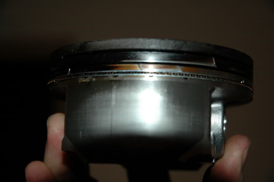

Yes, that is Loius's block. I did the tear down on it. It is those heads that we were discussing. Have you been talking to him about buying the exact same heads?
What happened?
Detonation happened on #4. destroyed the ring lands.
And as for why this block? Because, as has been mentioned I want something super solid for a high compression build. Why "detune" a 300hp block? Hmmm, let's see, To blueprint and close the deck on my stock EJ251 block w/112k mi on it and add the pistons would cost around $2000-2500. And ,my car would be undriveable while doing the work. Or, take this block, rebore it, add pistons and reassemble it w/a dynamically balanced for around $1000-1500, including the block? You do the math. The crank isn't knife edged, but it is shot peened from the factory. And of course the crank and rods are forged. Revving to 7500rpm with this thing will dreamy
Anything over 12:1 CR will make the car unstreetable. I want the car to be able to continue to run on pump gas. That will not make the max HP that the car is capable of, but I plan on having two tuning maps. I will have one for 91 octane for street and one for 100 octane for racing. Since Cobb is so slow on releasing the AP for the RS, I may be jumping to a LinkPlus pretty quickly here. But we'll see. I will be in SLC on Wednesday and plan to discuss it with Trey at that point...
