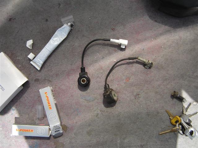

After I got arould to replacing the control arm and wheel bearing, the alignment was off for awhile, and I was getting some strange stubling and hesitation from low rpm at mid-to-high throttle. Threw code 22 for the knock sensor, I reset the ECU, and it came back so that was pretty obvious. Monday I had my car aligned (although there are still issues with that), and today I got a package:

Old and busted with a grey connector vs. new hotness:
It was a slight pain in the ass to get changed::
Hesitation is gone and the car runs great. I don't really like that the plug wires don't seem to fit all that snugly. I might be keeping the old ones in the car just in case.
