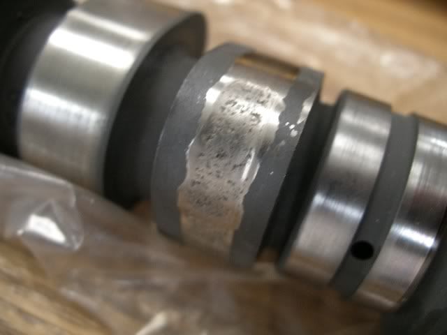

Here's my dead spicy cam...

geez what happened to the cam? looks to me that it got TOO spicy. :lol:

As for the cam, read this thread for the details...
http://forums.nasioc.com/forums/showthread.php?t=968707
