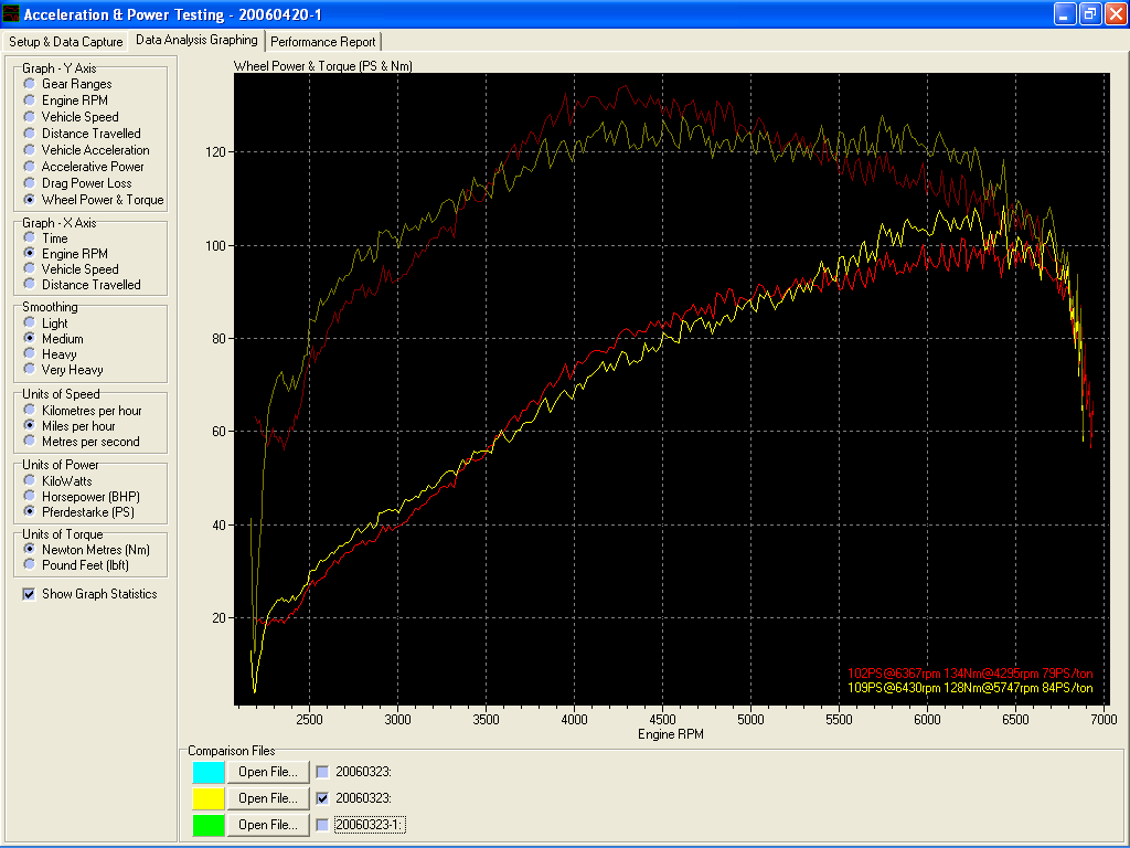

5300 rpms wow, what's the redline? Do you have any dyno charts?

We have 2.2 here, even in rally
I'm Happy.
4EAT - 6800rpm
Manual shift - 7100 rpm
http://s51.photobucket.com/albums/f353/ ... edia=image
