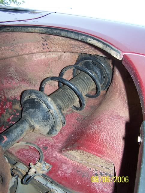

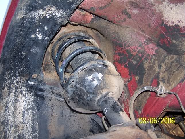

what do your rear springs look like? Do you have a picture? Because if they dont taper, I am pretty sure you can use them. Check out the Sticky at the top of this forum, the suspension compendium. It will tell you what fits the 91-94 legacys. I'm not sure if they changed after '94, so maybe you should try to figure that out somewhere.
