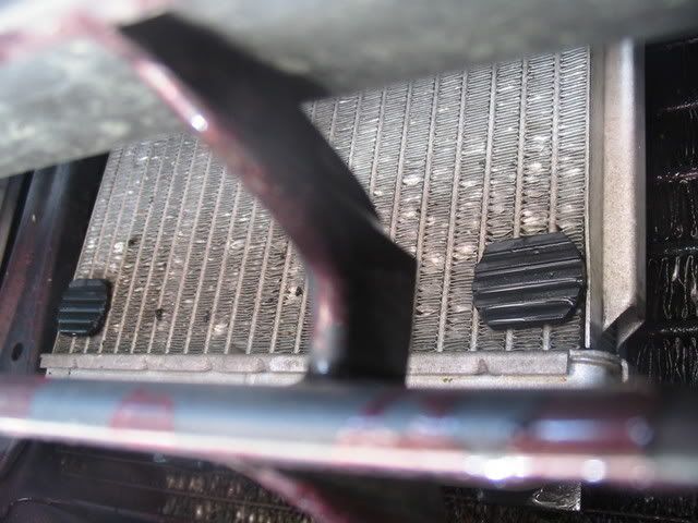

A shot of the heat exchangers (part of them anyway)

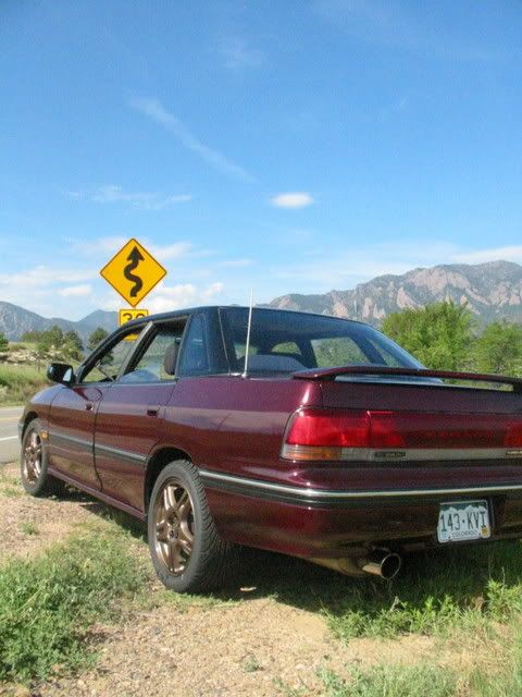

duplicolor broze (with clear coat) wrx wheels

Looks good man!
You mention heat exchangers.....are they for an AWIC, or front mount?

One more -
more typical view :lol:
And yup - custom Air to water intercooler
further mods = mbc at 13psi, 3" CES TBE w/cat, pulley, GR2's, end links, and some more minor stuff.

Me likey, looks nice!! :-D

Let's see that A/W. Where did the heat exchangers come from?

I am not sure on the manufacturer of the heat exchangers, I bought the car with the A/W installed already (done at a shop in Co Springs), and there is no discernable info on them. They are ~7" wide, 9" tall, 1.25" thick and are run in series. The intercooler core is ~ 12" long, 5" tall, 2.5" thick. Cooling fluid is forced around with a Johnson pump (again, I can't read the Mfg info for model#) through 1" OD tubing.
I've done some measurements of intake air at the throttle body, and found it to be reasonable after several 10-100mph pulls - But I would like a small resevoir for more thermal capacity.

strange shot of one of the heat exchangers

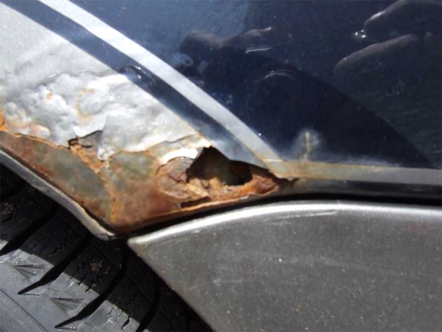

farfrumwork wrote:And I love the rust free zone we have here as well. I am from WI originally so I know first hand about what NaCl does to sheet metal :shock:
Tell me about it :(
anyways, the bronze looks waaaay hot! :)

wiscon_mark.... looks familiar :( one more reason to not move back the midwest - ever. (not to mention the winters - insert frozen emotioncon here -> ) And Thanks!

Question, what color are your Rex wheels painted or powdercoated???

My old friend John Stiener is a service rep there still I believe. Ask him about our little contest on Arapahoe with his S4 a few months ago (he did pull pull me unfortunately - though not much until >60mph, but I digress) . And my wrx wheels are Duplicolor Bronze, cheap and effective.
