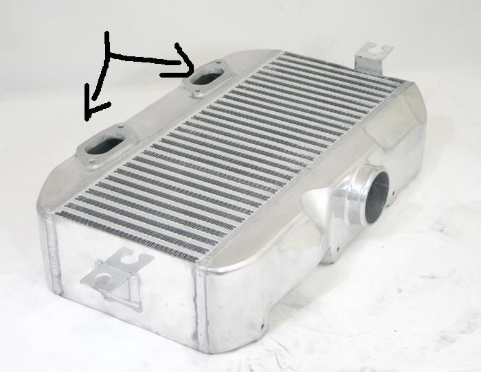

But if i in theory wanted to add an aftermarket BOV, all i would need to do is disconnect lines from the old and attach to the new? The intercooler in the pic below is the one i ordered, but want to make sure or a few things......Image
Is that where piping comes out of to run to the intake and the big round port in the front runs to the TB?

Post by gto7419 »
The two ports with the arrows take the "charged" air from the turbo, and the big single port goes straight to the throttle body via a single coupler.
