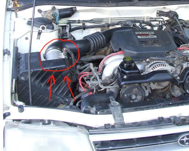

Ok, so I feel really stupid for having to ask this, but... this is the MAF sensor, right?
~Joel
scuzzy
Posts: 775
Joined: Sun Feb 20, 2005 1:53 am
Post by scuzzy »
jnorion wrote:Ok, so I feel really stupid for having to ask this, but... this is the MAF sensor, right?
Ding ding ding ding ding!
