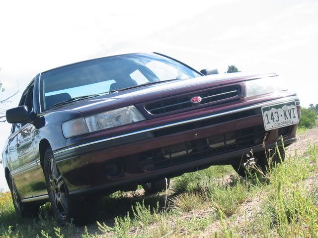

There is a good shot of the one, the only, G-FORCE :lol:
The custom-bent turbo to IC Al tubing is sweet I think. 8)
I believe the core itself is ~2in thick and ~10"W x 5"T (I'll measure and get back to this thread later)
The Cooling fluid (about 50/50 anti/water) is routed through 2 front mounted heat exchangers (about 8"W x 10"T x 1.5" D..... or so, that's off the top of my head, and again I'll get beter measurements and report back). You can see them here
Coolant is pumped around with *some* Johnson pump (can't read model #'s or anything).
As I replied to your PM Jefferson, it seems to work well in short bursts (like a awic should) but could use some more fluid reservior as it has NO extra fluid than whatever is in the system. I know it gets cooked as I climb Mnt passes and am on boost very frequently.
H2O is a great conductor, something around 25x more effective than water (again, speaking in rough terms).... but it also has that much Harder of a time releasing that heat once soaked. The water must be cooled by air at the heat exchangers, which, as stated, is less efficient than when it took heat out of the intake charge.
I think that a Good awic setup must have ample front mount heat exchanger setup (I'd like to get a aftermarket Cobra piece) and a bunch of extra water in reserve (I'm going to get on that 1st - it's cheaper and the best bang for the buck)
I do like it though - it's compact and well built. I thgought for some reason it came from the land down under...?
