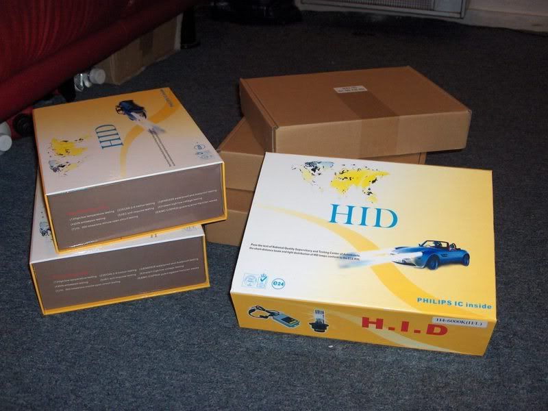

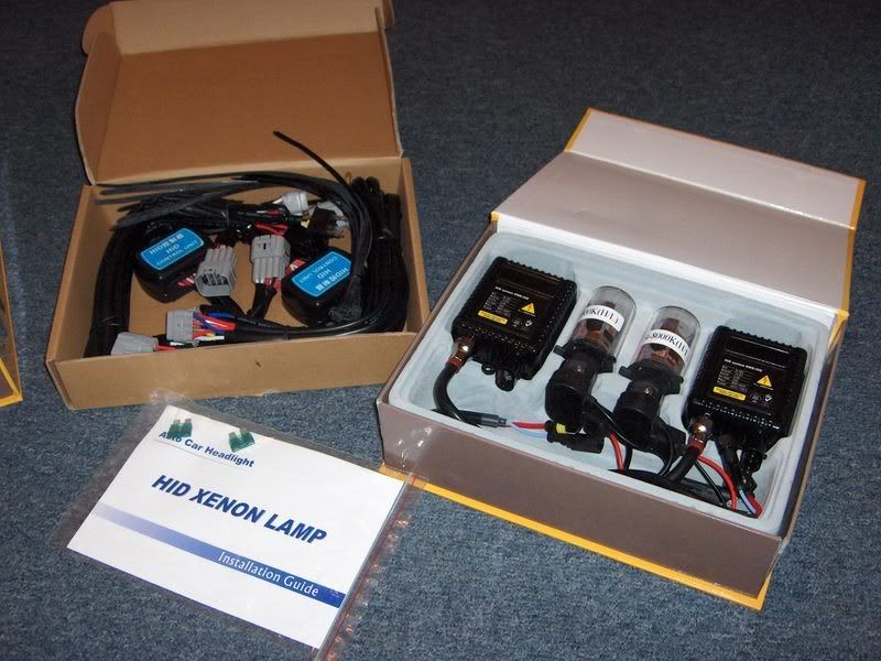

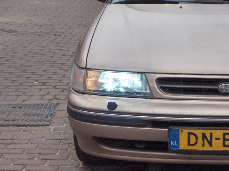

In Europe illegal? That's bullsh*t... :roll:
If they are strict somewere, it's in the Netherlands! I drive around with my set for almost a year now. Light beam is perfect after adjusting the headlights.
I searched for a H4 Bi-Xenon set, so High beam is still available. Found a nice set and even sold 20 other sets to Impreza drivers. Al very happy with it.
No light where it shouldn't be and no melting of what so ever. HID is only 35W and colder then your halogeen lightbulb!
Passengerside: Halogeen, Driverside: HID Xenon
Before adjusting the headlights, the lightbeam was too high in this picture.

I don't know the brand of the kit. It only says it has a Philips IC inside.
It has High beam, because that's obliged overhere.
And my lenses are glass, because my car is EDM :wink:
But that shouldn't make a difference, because it's colder than your lights.
"I feel Legacy"
