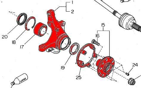

subej22t wrote:i believe your right, anything 90-99 and impreza 93-99 i think would work.
Yeah, I found this out when sourcing one for my 97. The only difference in that year range is ABS or non/ABS. And they are interchangeable if you don't mind losing your ABS

More like anything from a 90+ subaru except SVX, Tribeca, and 05+ STi parts. Although the 05+ Legacy uses a different bearing, hub, and control arm so those might not work either.
