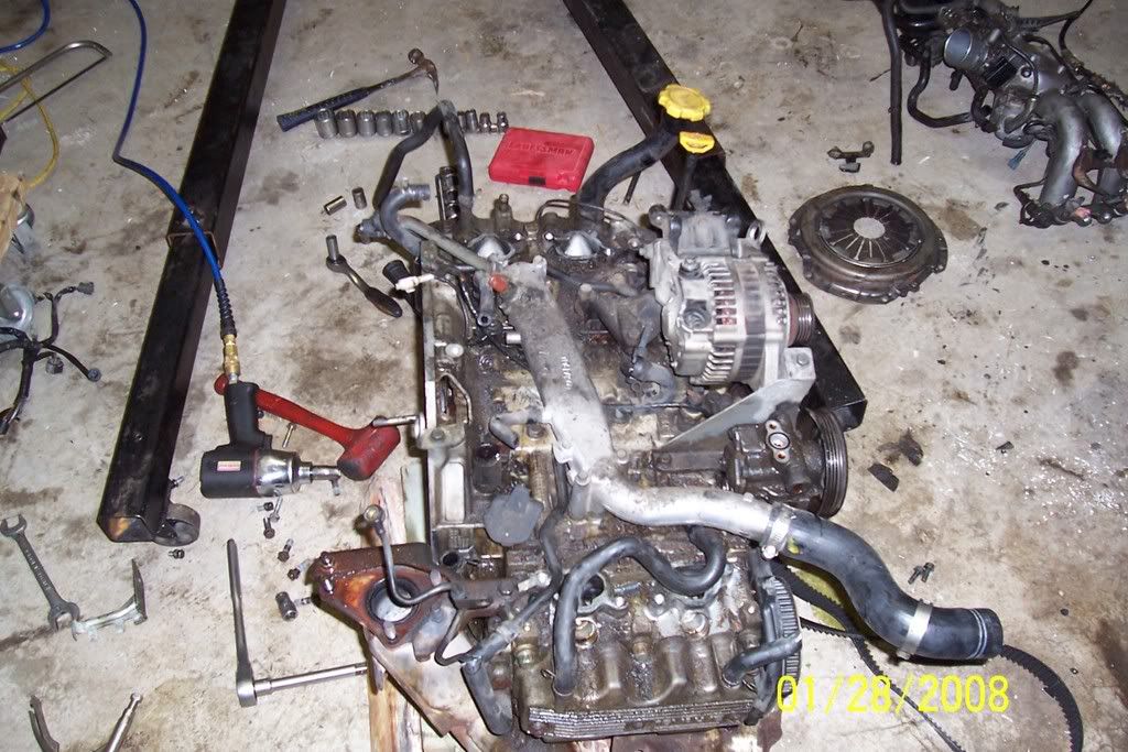

I will be doing a full rebuild on the engine, delta cams, PnP TD04, headers, and later.... standalone?
heres a few pics:

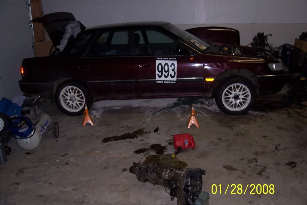

and an old one of the car

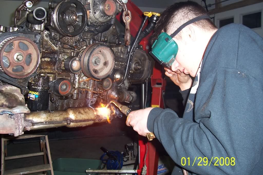

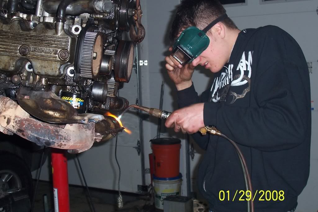

I broke off 2 bolts on the exhaust mani, so I just cut it in half lol
I will try to get some more of the engine with no heads on it, the cyls are perfect.

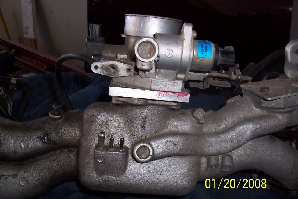

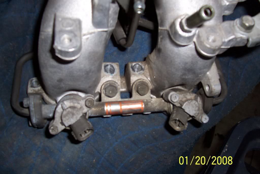

also, can anyone tell me weather or not the intake manifold is a 20g or 20k?

My understanding was that the EJ20K had a coil pack for ignition. If I'm right, since your intake manifold doesn't have a spot for the coil pack to be mounted, I think that means it's for an EJ20G, which uses coil-on-plug ignition.

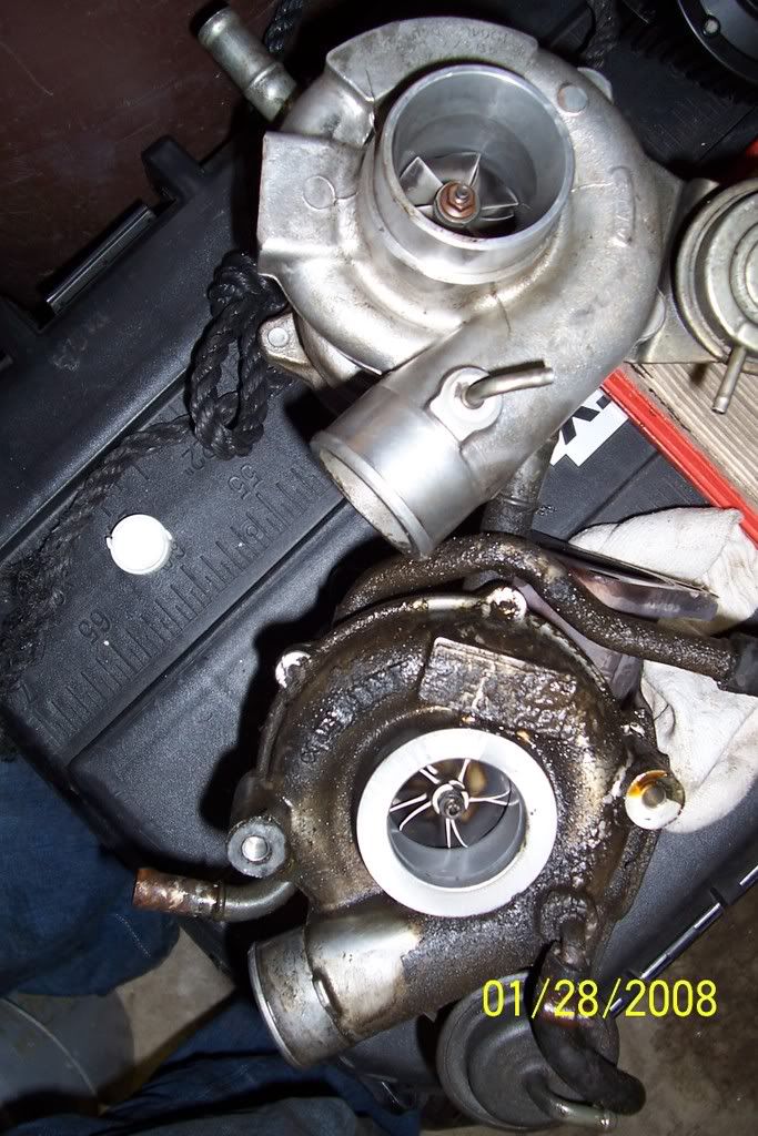

yea, my mbc line popped off and sprayed oil everywhere a bunch of times, also my turbo has been shot for the past year and some change, my next step is to get the internals out and get the block hot dipped.

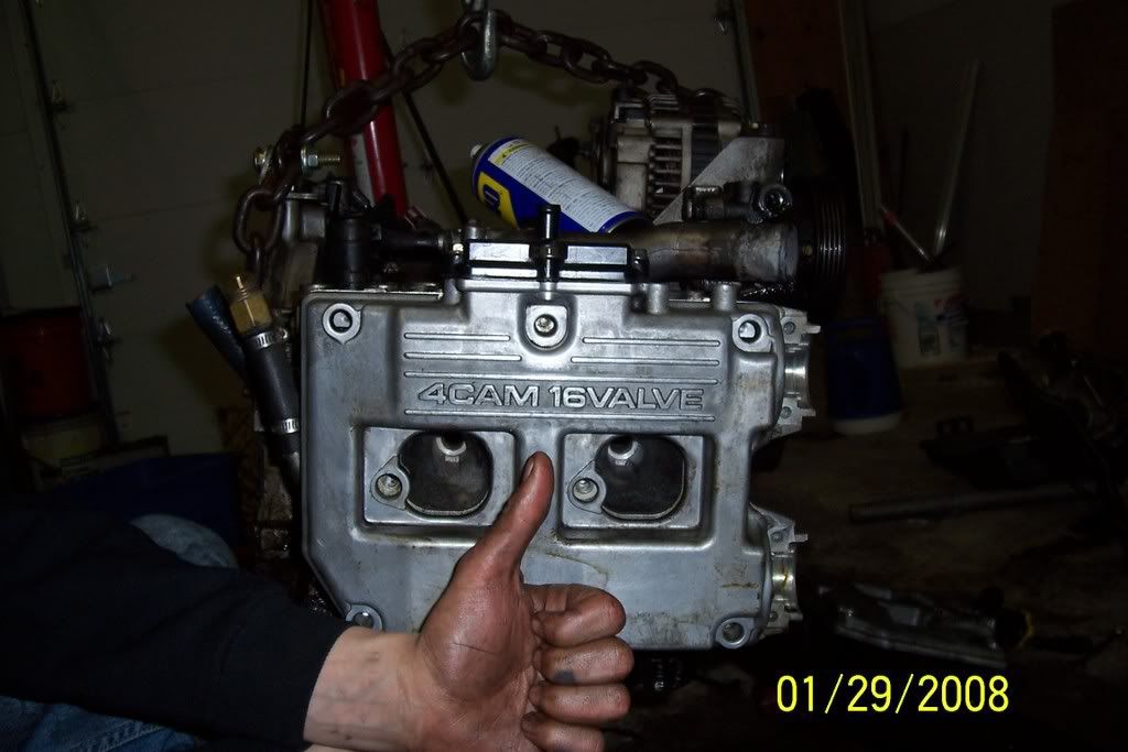

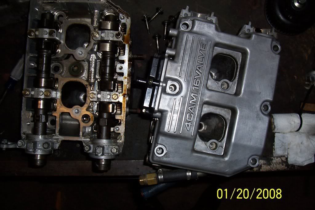

The manifold looks like its from a EJ20G, as EJ20Ks & DOHC 2.5s have mounting points for the coil pack.
Where is that t-body from? It looks wrong for a use with a ej22t ECU.
I see a block off for the IAC & a idle controller on the t-body. Was this used on a Ghetto DOHC'd 1.8 ??
I'd use that manifold with a ej22t t-body (complete with TPS...) & IAC.
I matched a ej22t t-body up on a EJ20G manifold in the past & the bolts lined up perfectly.
If the heads & v-covers came together (& are from a turbo motor) I'd say they look like EJ20G heads.
EJ20K v-covers are smooth (at least the ones on the motor I have in the garage is), while EJ20G's have the writing on them.
I've seen EJ20Gs with both plastic ('95 WRX) & metal cam gears ('93 WRX).
That ej22t is probably one of the dirtiest I've seen!
It drives me nuts just to have a small amount of oil stain the motor now that invested many hours cleaning it up during my recent tear down for a head gasket job.

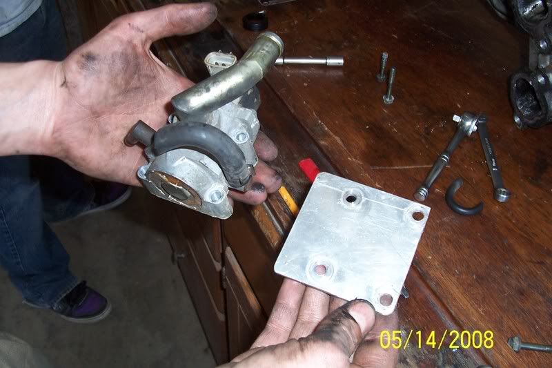

I was planning on using my throttle body from the 22 anyways because its larger than the one on the 20g manifold.

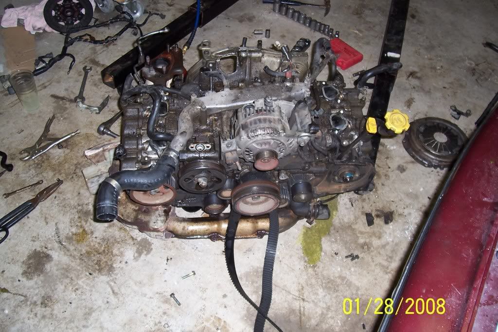

I will take some more pics tonite because I am starting to tear the engine down.

and yes, my 22t has had a shot turbo and leaky main seals for quite some time, I will make it up to her though!

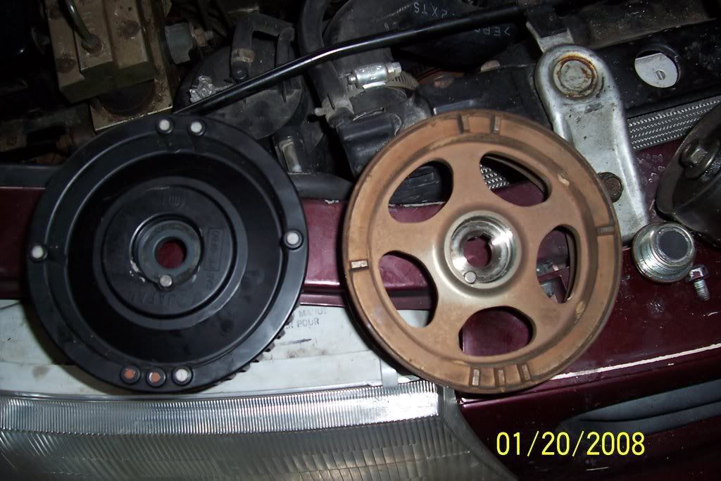

so I MAY have ran into a small problem.... turns out the heads are from the 20 R engine.... does anyone know if there are any differences in the cam gears, or intake manifolds (20g-20r)
Tim
93 Legacy SS Winestone 5mt swapped
Megan Racing Bellmouth 13psi
WRX Intercooler and Hoodscoop
JDM ej20G DOHC head swap, wiseco pistons and td04 in the making.
Should be OK. You will need to plug the unused oil and water ports on the far side head.

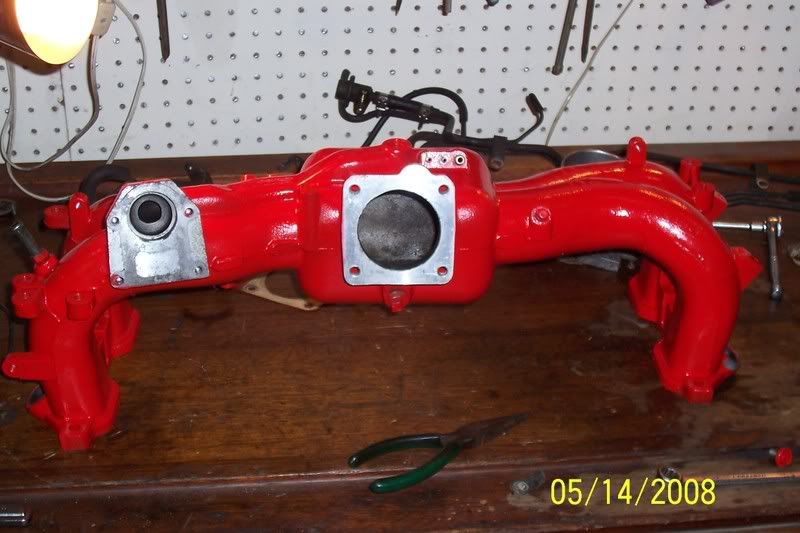

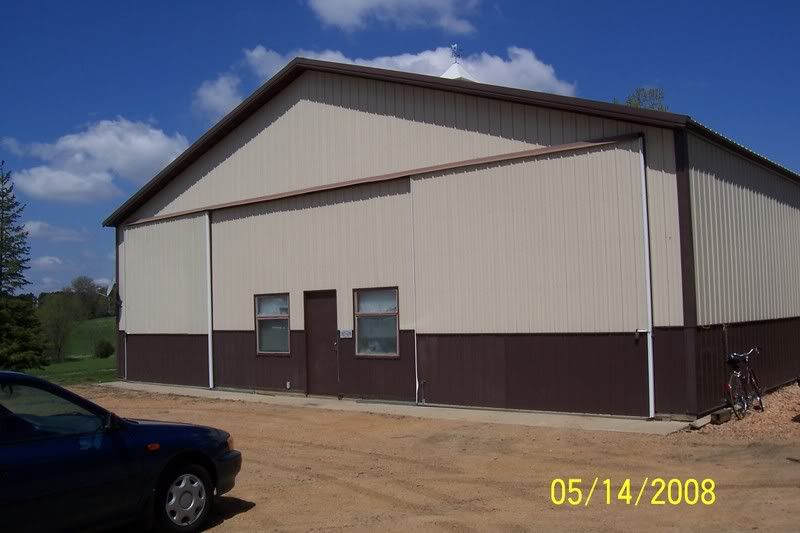

I moved into my new shop, so get ready for LOTS of updates!!!
I got my IAC and throttle body bolted up to my intake manifold and its looking like its going to be a pretty straight forward swap!!!!
yesterdays progress:
