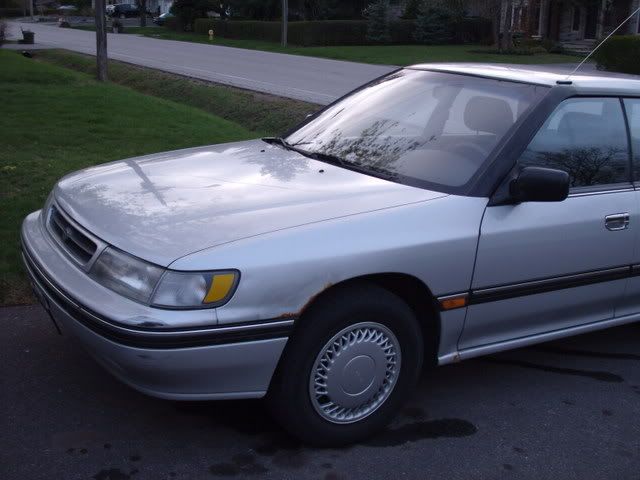

Hey guys. I currently have 14" steelies on a little bit bigger tires then normal not much. Anyway found a good deal on some impreza RS 16" alloys in gunmetal with kumho tires almost like new tires. (around $300 for 4). Only reason I can get my dad to get these wheels would be fuel economy. I am looking at it from a handling perspective and appearance. Showed him a pic of the ones on TheSubaruJunkies but he still thinks it's a waste unless it saves him money lol. Any ideas thanks.
