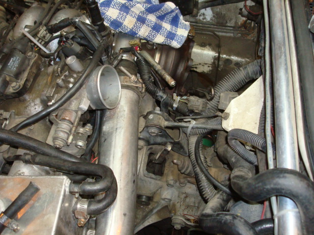

Found a guy on nasioc with a 2.5 RS trans, which I think is a 3.9 hydro push type. Since I have never seen a hydro push type up close I'm worried my intercooler pipe might be in the way if have to make the switch from pull to push.
Heres a pic, my pipe runs along the back on the block under the coolant tank area.
BAC5.2
Posts: 9026
Post by BAC5.2 »
It might. Does it touch the front of the bell housing on the drivers side of the transmission? You need about 2" above the bell housing to be clear.

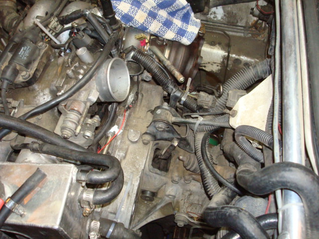

Ok here is a better picture of the piping in question.
Without pipe:
With pipe:
And the broken tooth:

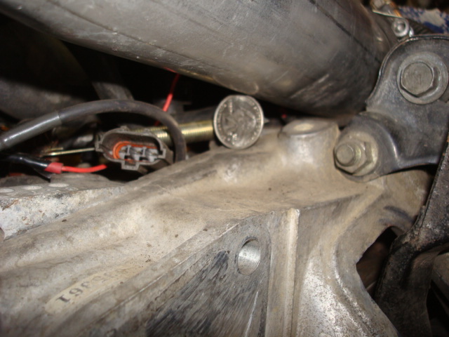

Take a picture from the clutch fork looking forward to the front of the car. I need to see the clearance between the pipe and the bell housing.
biggreen96
Posts: 961
Post by biggreen96 »
ask and you shall receive:
