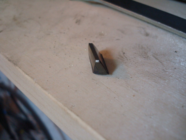

Ok here is a better picture of the piping in question.
Without pipe:
With pipe:
And the broken tooth:
