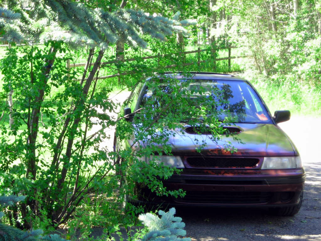

This leaves us with a hole that has recessed tabs and you realize that Subaru does a much better job of fitting scoops on/in than you evar could
Sorry about no pics yet, but all the above work was done too long ago...
At first I was cutting cardboard silhouettes and taping stuff and measuring stuff and pencilling lines and junk
but in the end I just plopped the scoop right on the hood using the center bolts and holes to make sure it was center and eye-balled the front/back position of both sides. Don't tell my dad.....
then I sharpied the outline onto the hood. Didn't get a pic of this... but it was hard b/c the stubs on the bottom of the scoop make it sit above the hood.
My recommendation: Trace a conservative outline and err on the side of the hole being too small! It is SO easy to widen it later with the dremel!
The dremel with cut-off wheels did the trick well. You can be very precise and I used less than 1 pack which cost about $8
If you are patient and thorough you can match the curve exactly
Someone else on here has already written that a dremel is the way to go on this one because then you can cut the top layer only exposing the bottom layer.
Then the scoops stubs and bolts that come out the bottom can go through holes you drill in this second layer.
got some shiny urethane locking nuts to go on the bolts
The height that the second layer is at is perfect and the scoop will be flush to the hood. Lucky!
At first this side was a bit small so I cut off an extra 1mm from the top side, now its tite!
but this side is where I was too rash when tracing, and it shows. I guess i will have to bodyfill the whole scoop in some day.
so as you can see it is good from far but far from good

very nice... like the peek through the trees...
