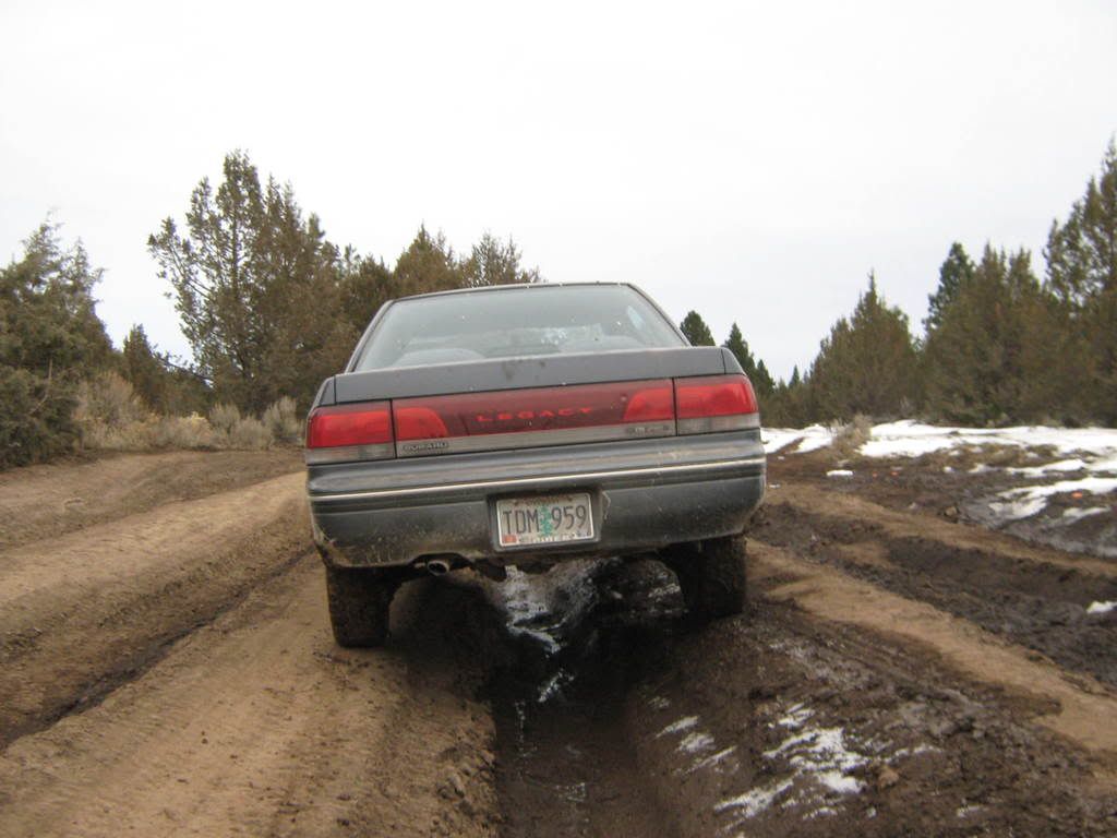

The tires you want to try will fit, no problems. I did the Outback strut/spring thing on my 92 L Sedan, and have put 205/75/14s, on the stock wheels, with no issues. Clearance is tight, but it definitely lifts up the car, and helps with off road...
