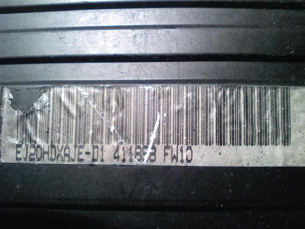

How do I find out which version or year this motor is?

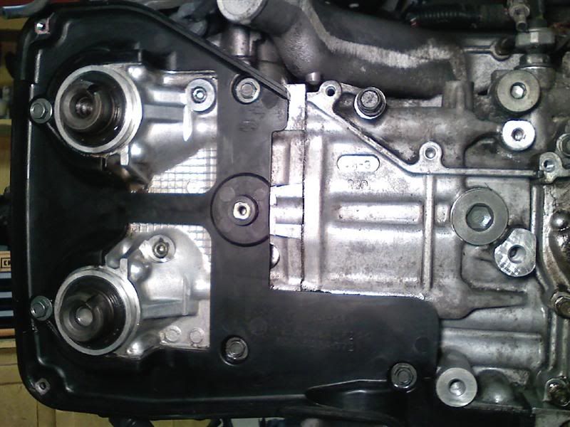

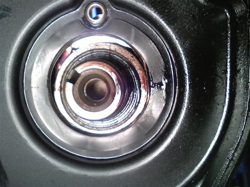

Outside of timing cover.

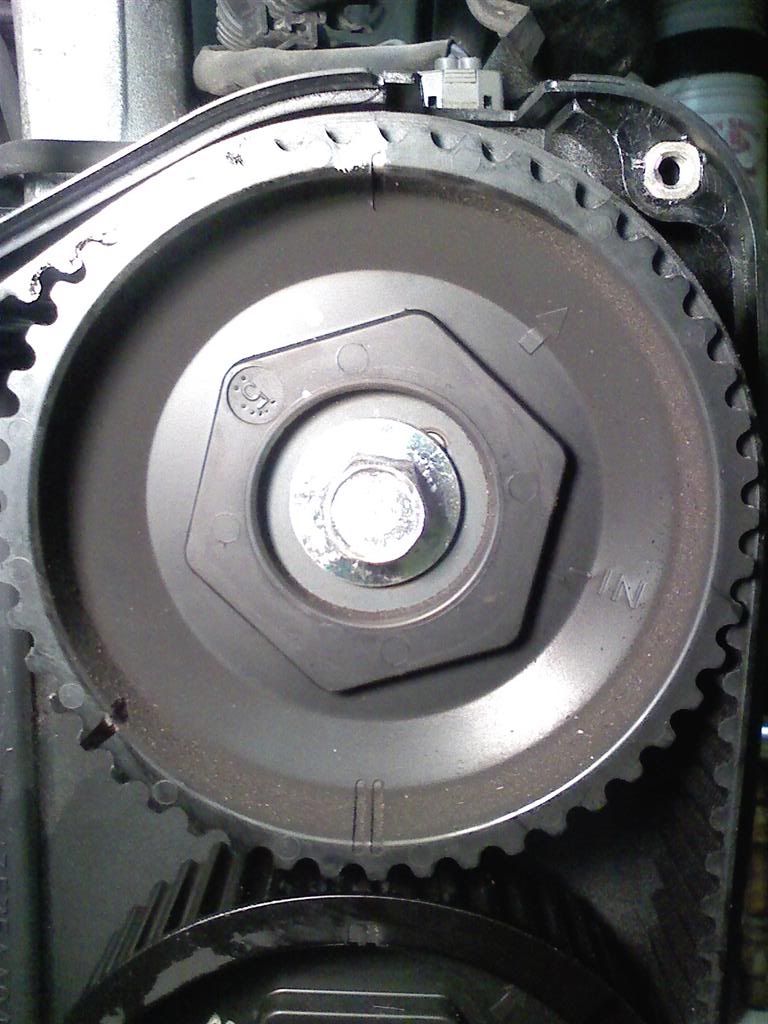

Inside the timing cover.

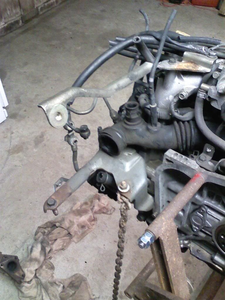

The wiring harness is cut. I have a 91 EJ22T intake and wiring harness. The intakes are different. The JDM one has some vacuum lins coming off the front of the intake that the USDM intake does not have. The coolant fill tank is on the opposite side. Probably other differences too that I haven't noticed yet.
Can I use the harness from the 91 EJ20T with the Intake on the JDM motor? Or should I swap over the whole 91 intake and harness?

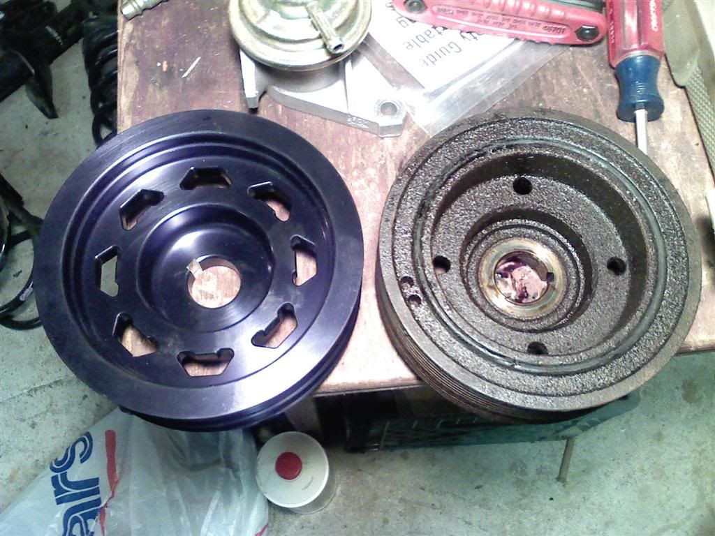

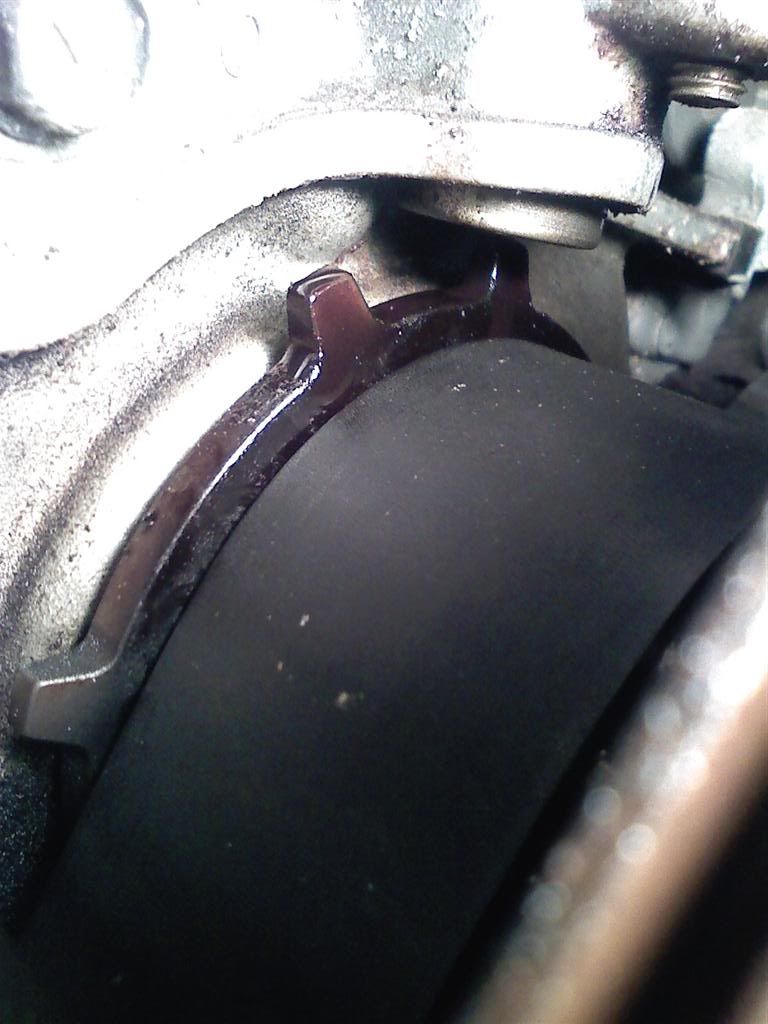

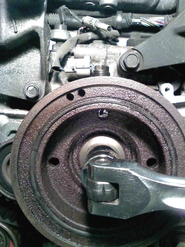

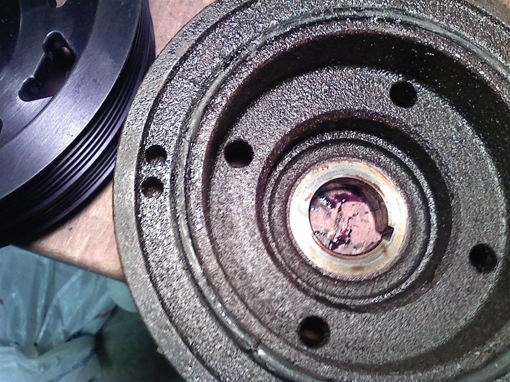

When I took off the crank pulley I couldn't see a timing mark. Is there supposed to be one? I have the group A lightweight pulleys that are going on and it doesn't have any marks either.
Do these two little holes have anything to do with it?

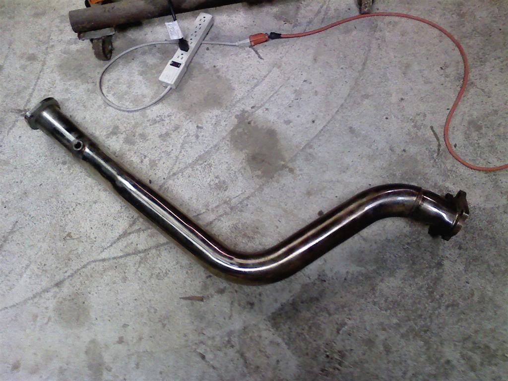

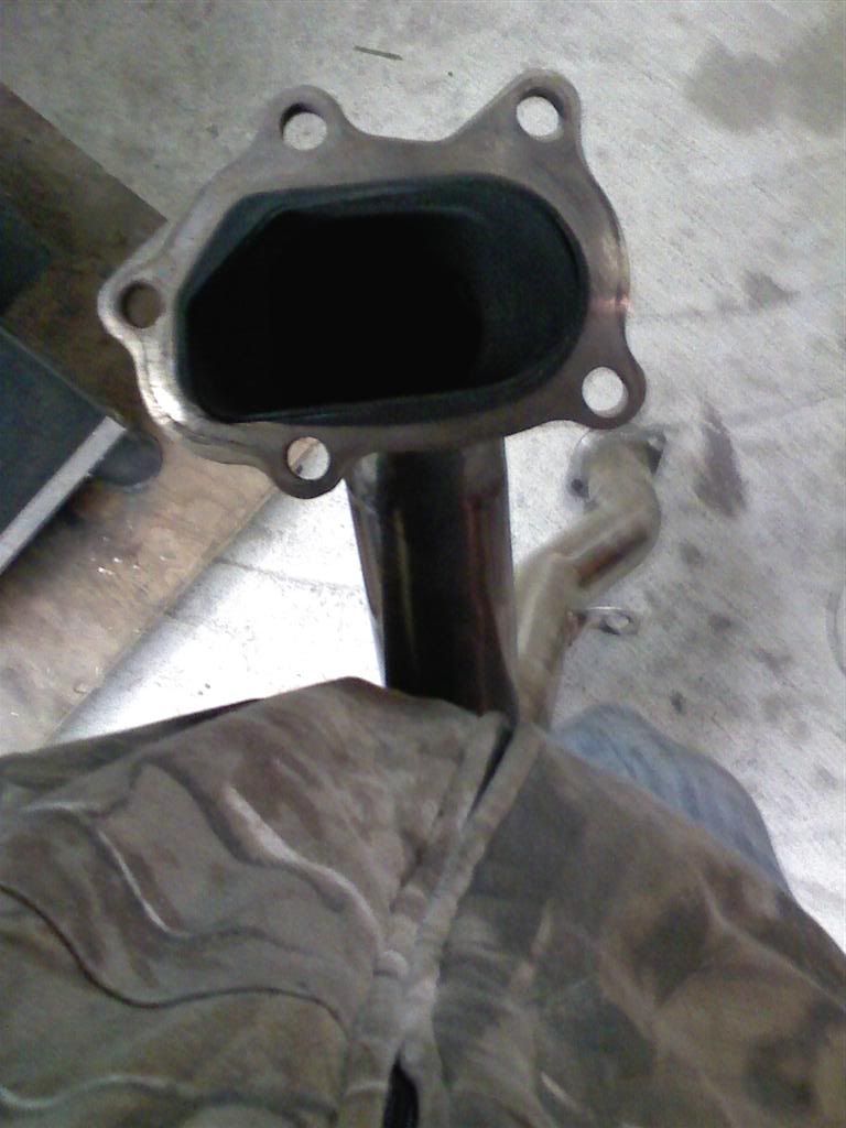

I have a mystery 3" downpipe that I got with the car and I think the O2 bung is on the wrong end. It's on the outlet end. Should I have a bung put in it up by the turbo or lengthen the O2 wires or sell it and get the right down pipe?

Have an O2 bung welded in by an exhaust shop before you install it.
I meant the stock USDM legacy turbo intake and harness. Will the harness work with the JDM intake? Or should I swap the USDM intake on with the USDM harness?
Or is either possible at all?

EJ22T intake manifold will not fit on the DOHC heads.
You need an EJ20G, EJ20K, EJ20H/R (twin turbo) or a USDM EJ25D ('96 - ~'99, DOHC) intake manifold. There might be a few others, but those are the most llikely to be found.
EJ20G is designed for the 90degree turbo inlet, but the others may work with it also. Use your O.E. EJ22T intake manifold harness. Some of those the coil will bolt on to, others you will need to fabricate a coilpack bracket. Some of those you will need to lenthen the IAC wires.
The EJ25D intake will need the EGR port blocked and is a non-turbo manifold, but the IAC is in the same spot as the factory EJ22T and has a coilpack mount cast in.
So are you saying the EJ22T harness will work with the EJ20 H/K JDM intake? Or do I need to buy a new intake and harness?

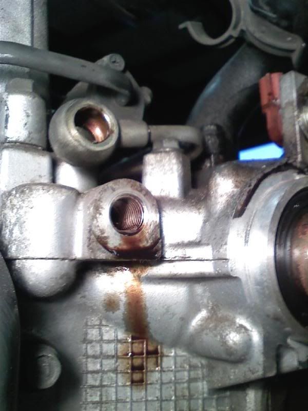

Since it's twin turbo and I'm only using one TD04 turbo, do I just find a bolt that will fit in the oil and coolant line holes and block them off?

All those seals and the plate are the same as your original engine. For easiest reference and to avoid confusing the guy at the parts counter just ask for parts for a 1996 DOHC Ej25 engine.
You can use your intake wiring harness on the Ej20 manifold. You will need to futz with a few wire lengths for certain sensors so unwrap it and test fit it before you install it.

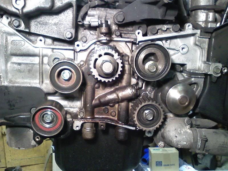

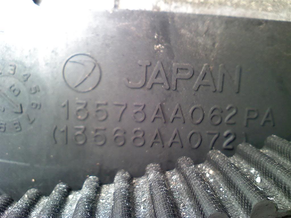

I was going to remove the timing belt, water pump and oil pump and get a part number off the water pump to order a new one but I got intimidated by the timing belt setup.

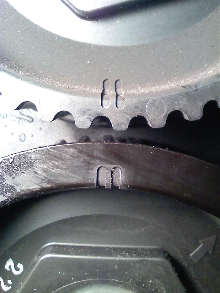

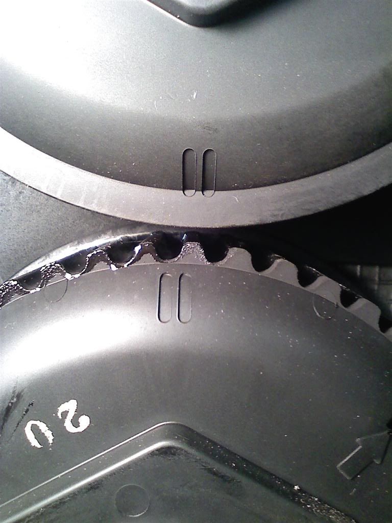

What are the arrows for on the cam sprockets? In the haynes manual it shows that you are supposed to line up the notches to the notches in the plastic timing cover and the double notches to the double notches on the sprocket below it. I did this and the right side was lined up good and the left side is not lined up good.
I don't know which cylinder is number one. In the haynes manual it showed a picture but doesn't show you which side of the block is the front. None of the cylinders were at TDC when these marks were lined up.
The haynes manual says there's a notch in the crank pulley so you can see when it's at 0 degrees but that notch is nonexistant on this crank pulley. I know there's a notch because my old legacy had it but this one does not.

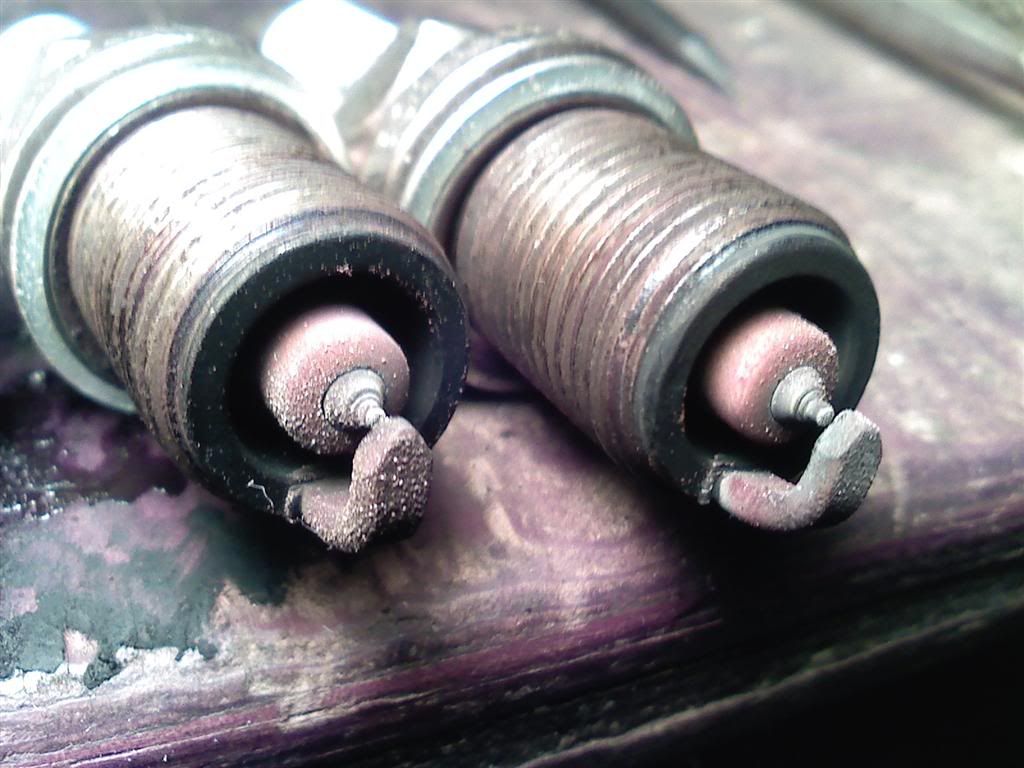

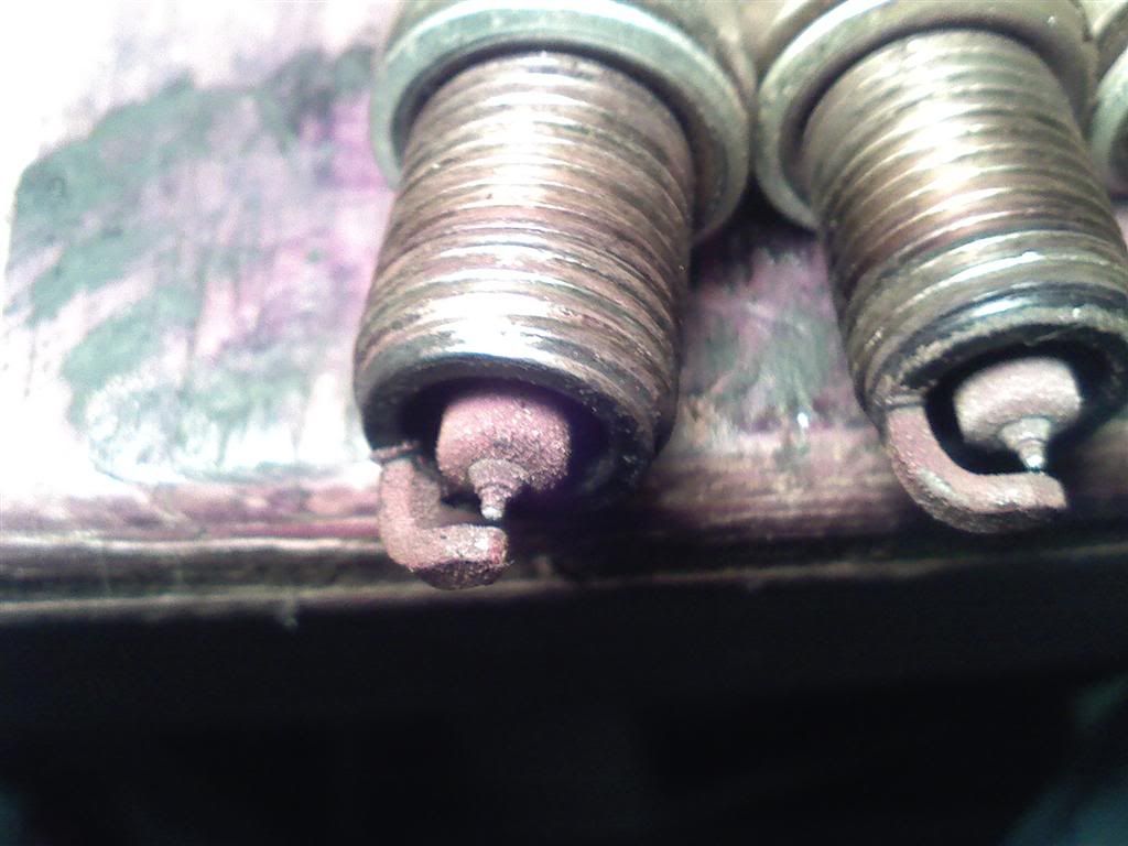

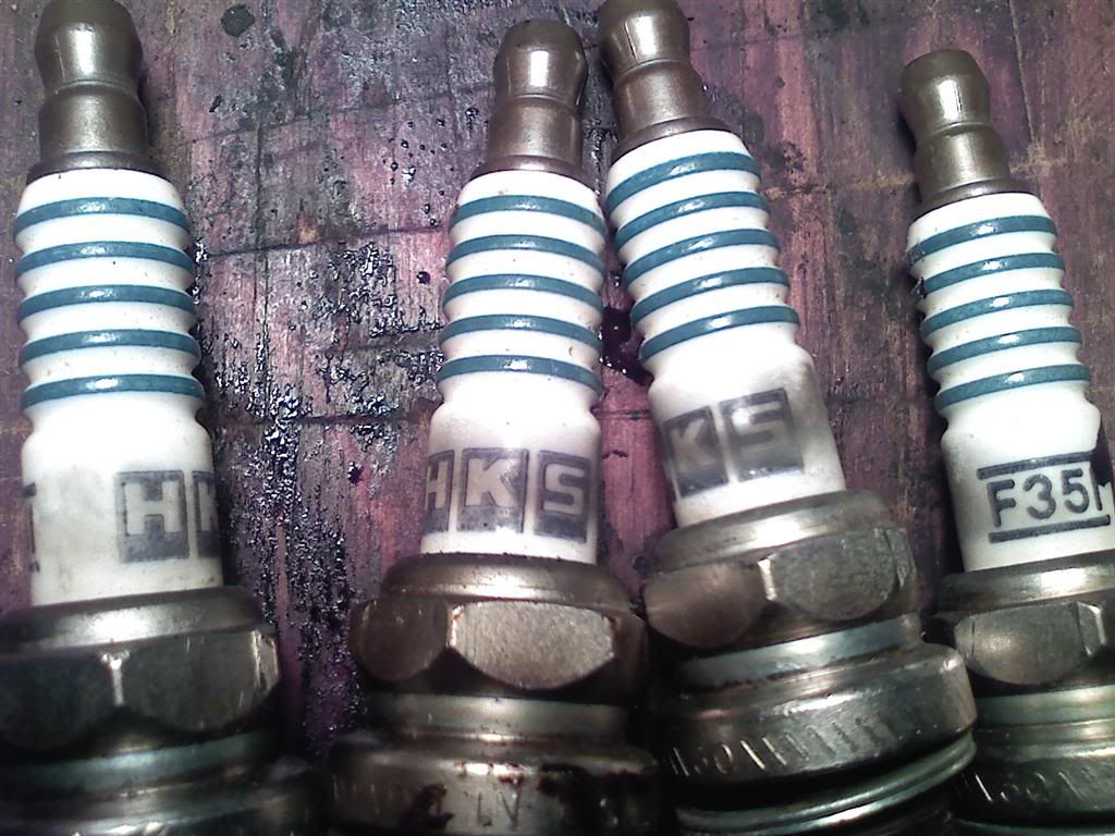

What do you think of these spark plugs? They're red. This coolant pipe is white inside and there's white sediment all over inside the coolant fill tank.

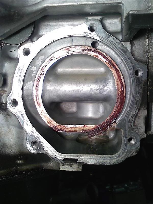

Seperator plate appears to be leaking oil.

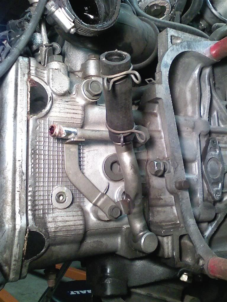

I was trying to remove this hose because it goes to both turbos but I'm obviously only using one. I found out that the intake has to be removed to get to a bolt on the bottom side of the manifold that's holding the pipe on.
Does this come out? I unbolted the bracket for it and it's solid. Doesn't want to budge. Do I just block it off somehow or will it come out and can I put a bolt in the whole if it comes out?
My EJ22T intake manifold does not have these hoses and metal pipes on top of it. Do I need these? What is this sensor with the yellow sticker?

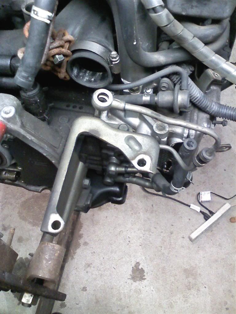

What did this wire go to? It's been cut and I don't see a sensor anywhere that it would have gone to.

On my Car that Cut wire looks like the one that goes to the EJ22T knock sensor, except in a diffrent location.
That Sensor with the yellow stocker, that is the IACV. Idle air control valve, it is used for cold starts and lets the car idle properly.
I believe all those line on top are the fuel lines.

What about the timing marks? Is it ok if one side is of by that much?

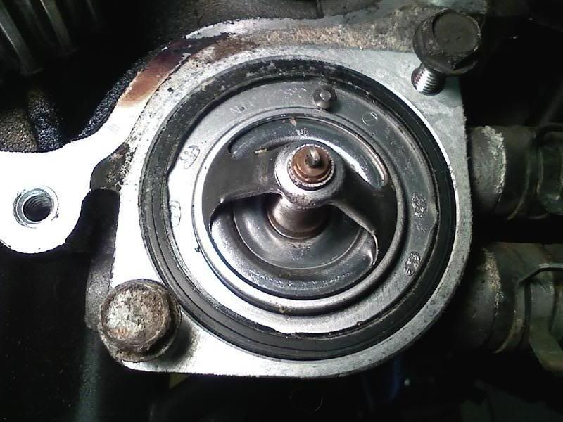

I got my water pump today and it didn't come with a gasket either.
Do the water pump and oil pump not use gaskets on subaru motors?
I looked up the part number on that seperator plate and it's for the 2.5 engine 96 and newer I think. I knew it didn't look the same as the metal ones I've seen on the EJ22.

The plate number is the same one for the EJ22T.

You will need to buy a water pump gasket.

Twin turbo was out of a JDM Legacy, which probably had the Sport Steer option, the cut wire on the front of the block is probably for that, it would go to a solenoid on the power steering pump which is located right about there.
Ignore it, just make sure there's no wire strands hanging out.
That crap on the plugs is usually caused by gasoline additives.

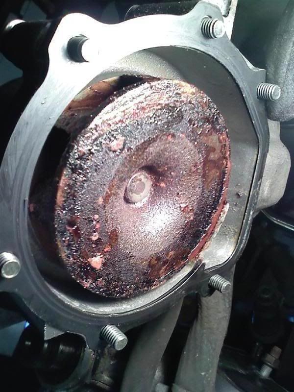

White in the cooling system is Aluminum oxides, previous owners used cheap anti-freeze.
I'd recommend Pentosin anti-freeze, does not react with Al or steel.

When I removed the cam sprockets I found that two of the cam seals was leaking oil pretty badly.
Rusty water pump. Eww...

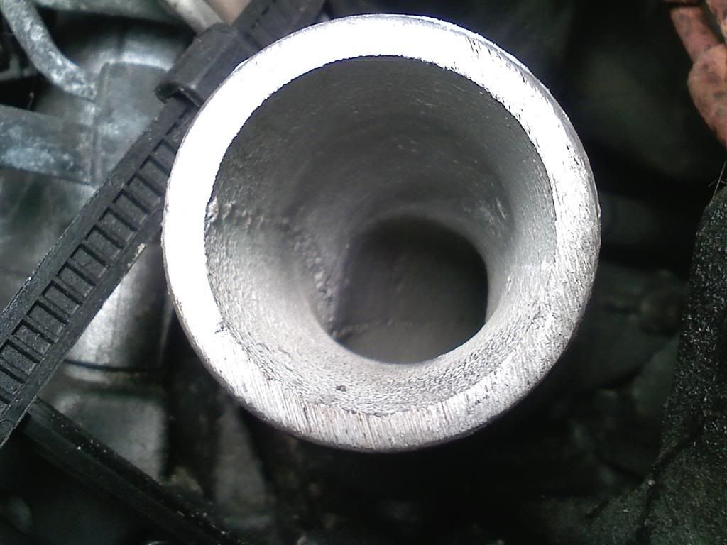

The driver's side head with oil feedline for one of the turbos. I bought some bolts to plug these holes both on the front and back but they're too long and need to be cut first.
