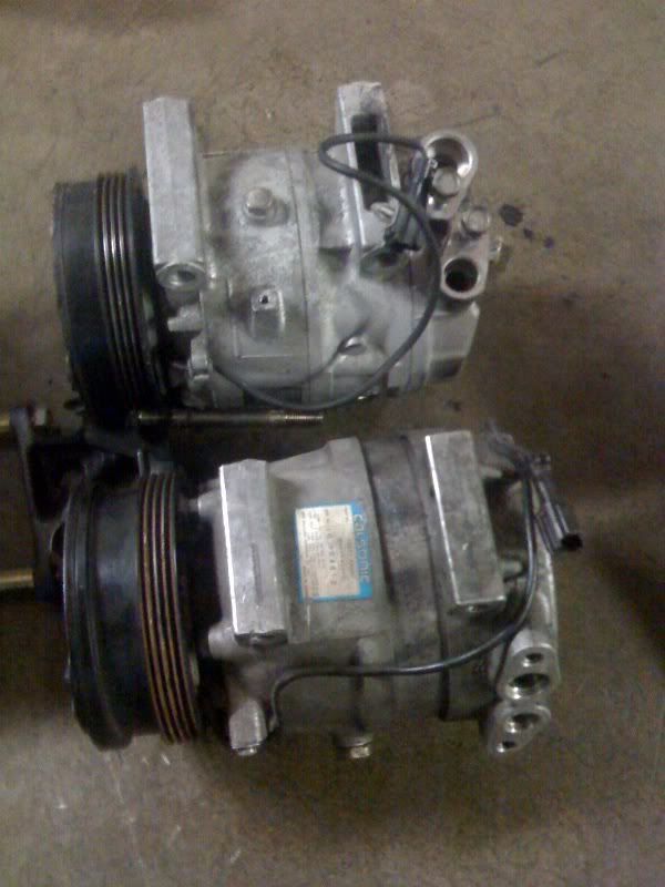

my ac compressor on the 91 legacy went dead on me and i was looking for a used replacement.
anyhow, i got a 92 calsonic model and my mechanic told me that it's not quite the same.
anyone have a picture or can verify. i have a picture but can someone host the pic?
thanks in advance.

Yat, please email me the pictures of the one I sent you and if you have a picture of the original. I will be happy to host the pictures for you and post them up on the board. You can email them to -

Per Yat, the top compressor is the original and the bottom one is the one that came out of the 92'.

the question is whether the top one is a zexel?

i got another picture from the mechanic and the top one is also a calsonic.
anyone else can confirm that the 91 calsonic is different from the 92 calsonic?

the shop purchased it and it's the same as the 92 model calsonic......somehow, i knew this would happen, even though the sales guy assured me that it should fit......
anyhow, i am going to take the compressor back from the shop and take pictures and send it off to the supplier......

my 91 legacy ac compressor also is a calsonic brand but it's a different model than the 92 legacy. the problem is in the fitting location.
The diesel-kiki version is the right one. i should have the new compressor tomorrow.
