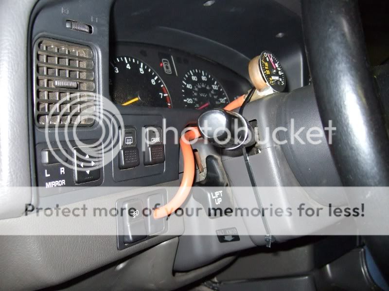

I love this steering wheel.
I'm pretty pleased with my vacuum hose solution here, though I should get some black hose and a back-lit gauge...
