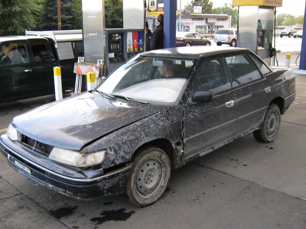

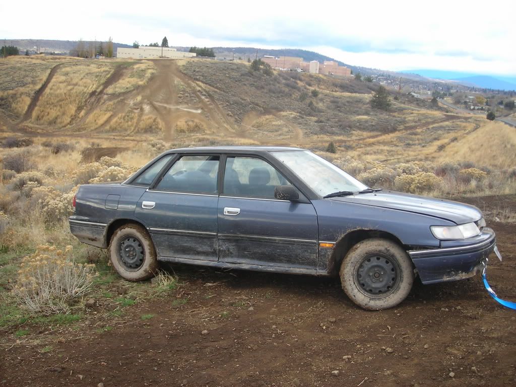

Gettin some less than $2 a gallon petrol...you can see the knobby goodyear ultra grips too.....check the clearance:

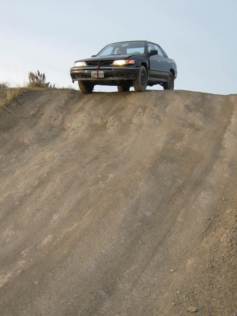

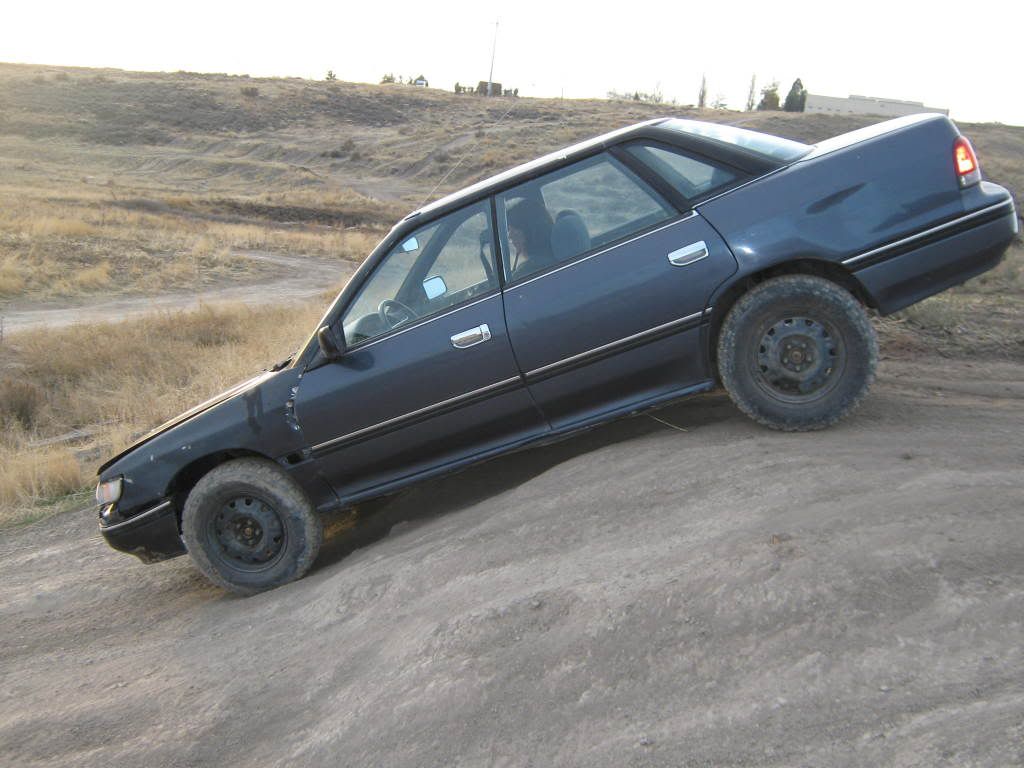

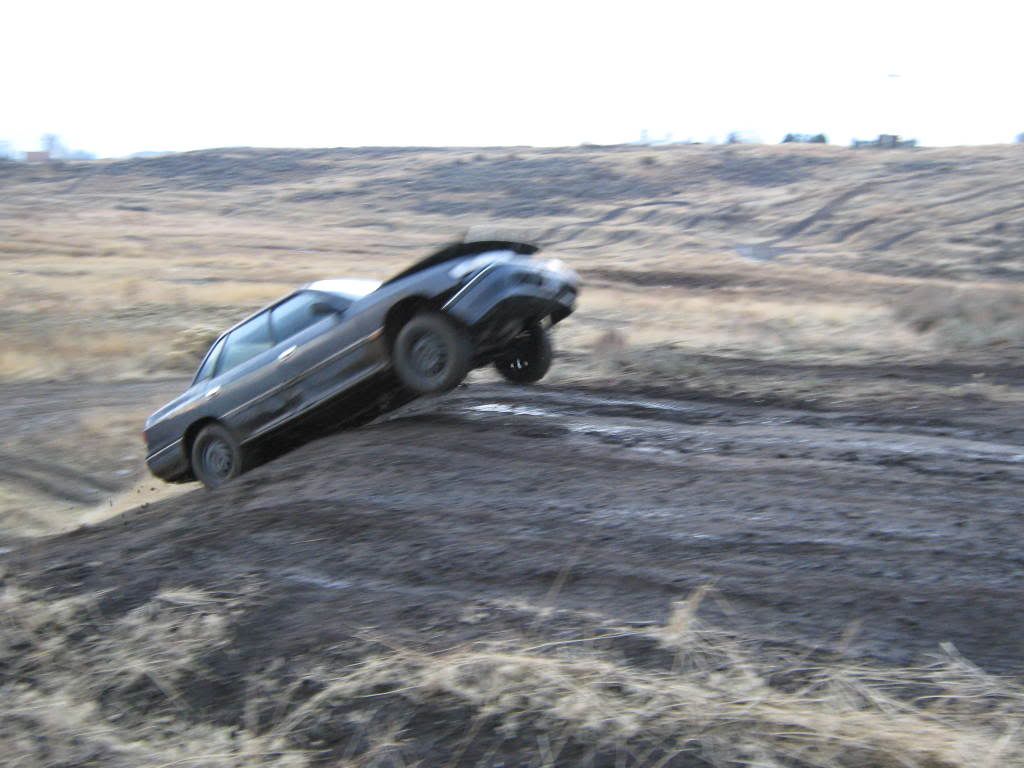

This is the slight hill that we jump frequently.

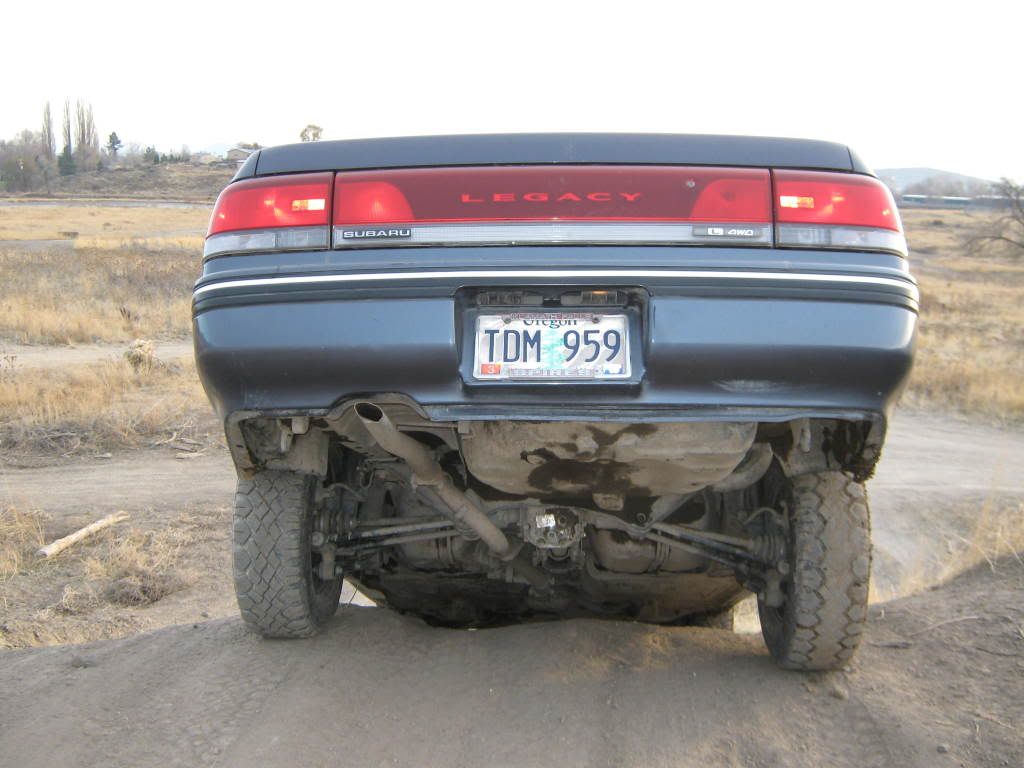

Check out the tite high performance cat back! LSD rear end too...for drifting of course!

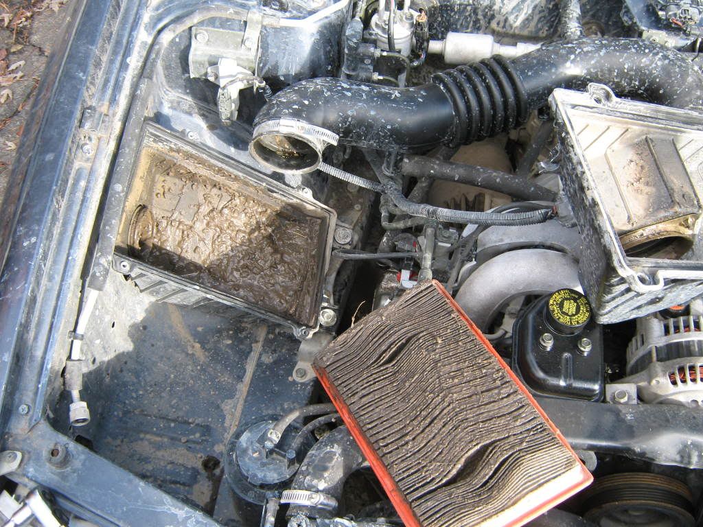

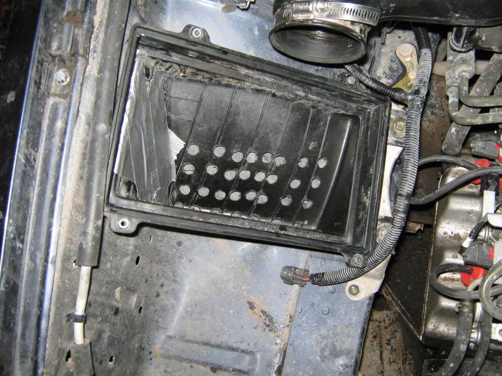

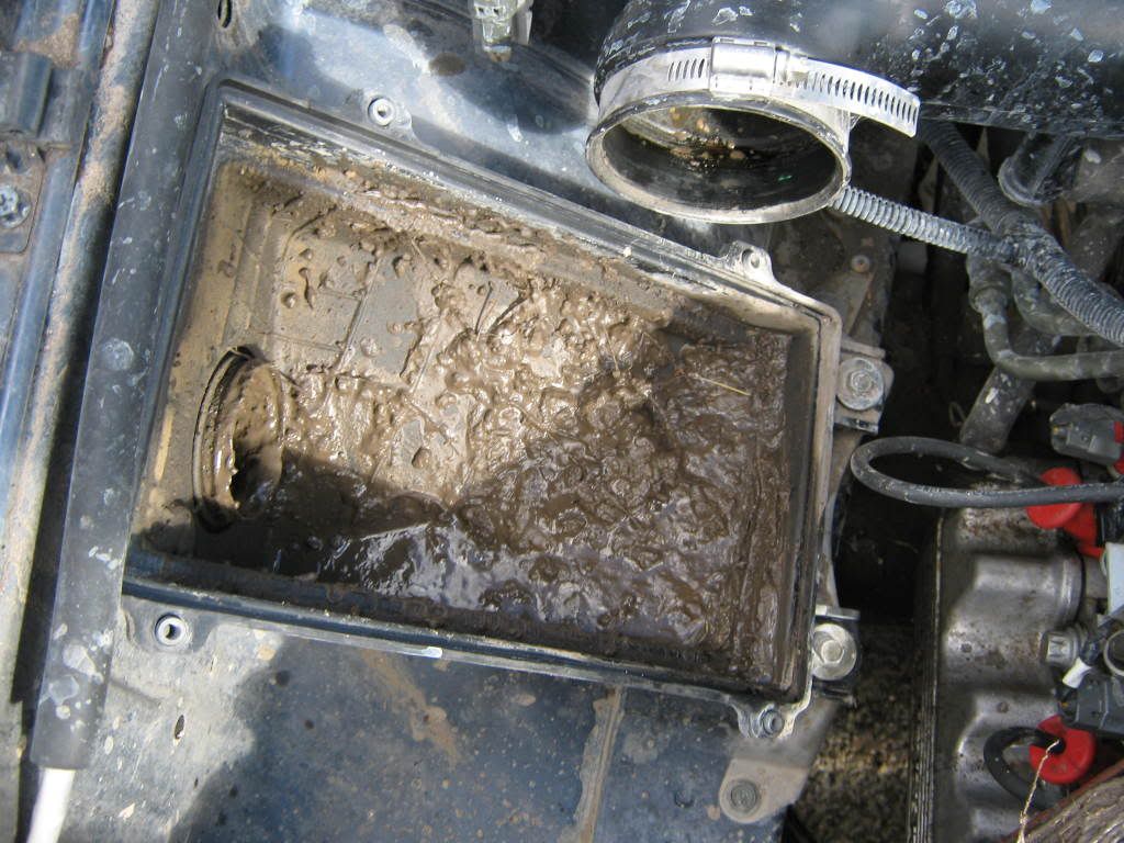

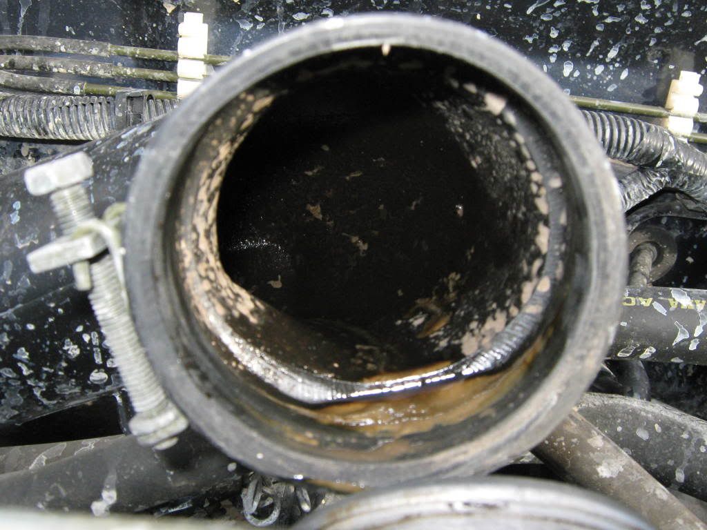

Had to clean the airbox of 5+ lbs of mud and shit first:

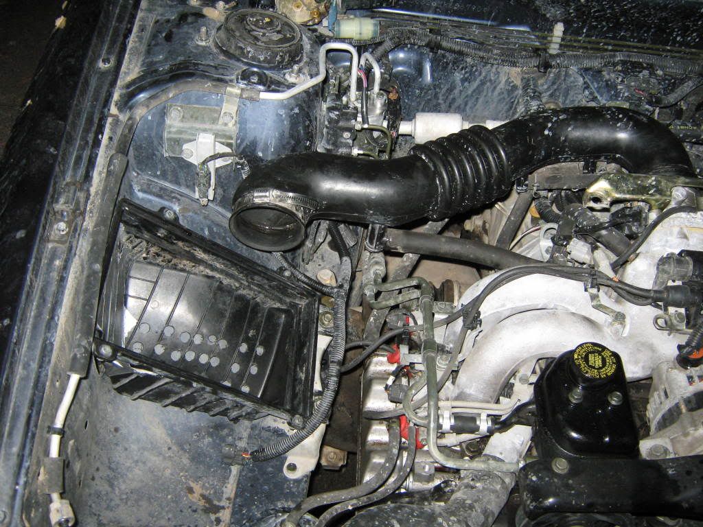

Cleaned it all up, new air filter, and some extra holes in the airbox:

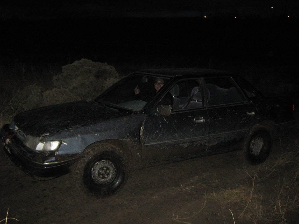

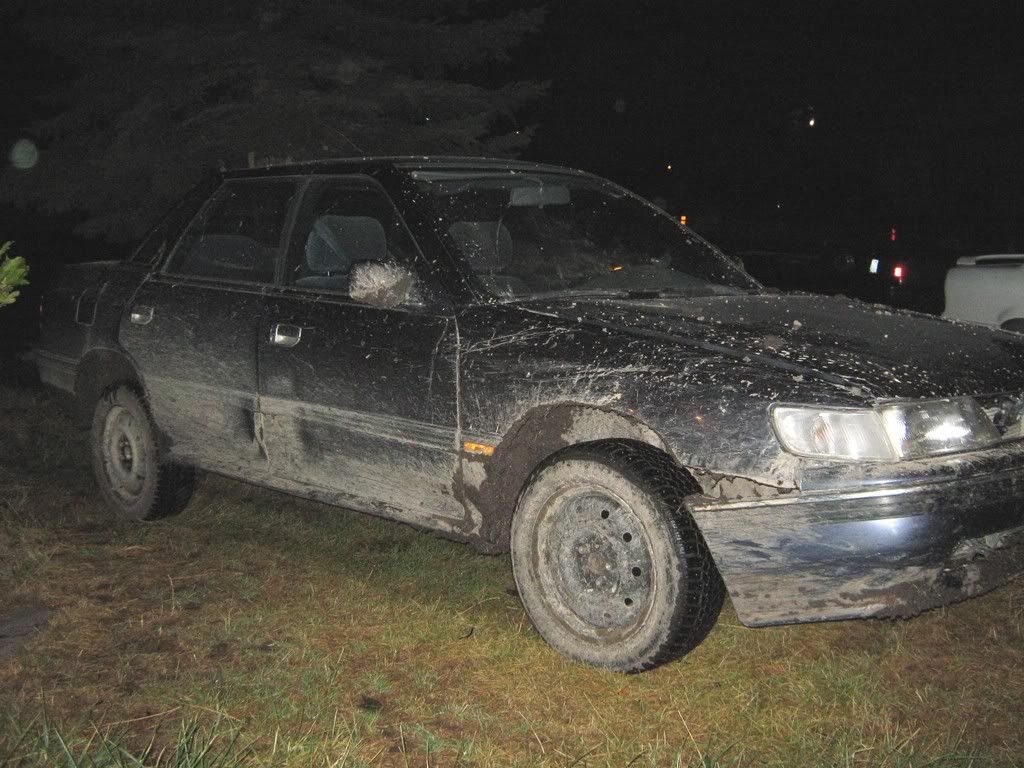

Chris followed with his 4Runner, and Ian rode along for one jump......lol.
Good stuff, until shit broke.

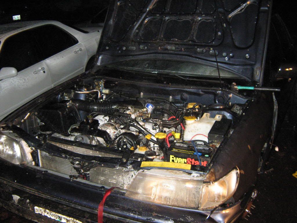

Nice man those are some pretty cool vids, your jump was the best! How do you get the hood to stick down now?

the whole front end is pretty tweaked....now it has a ratchet type strap holding the hood down. Wire broke too easily....lol.

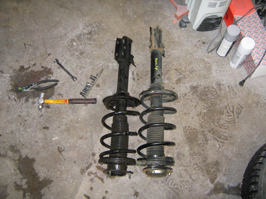

Yep, great fun....I put stock outback wagon struts (longer) and springs (more travel) on the car.....the fronts were just remove and replace, while the rears I had to disassemble the strut hat, as the older legacy and the newer legacy ones are different bolt pattern.
Cool mod for $80, and about 2 hours worth of not hard work....between that and the airbox, its pretty much stock otherwise.

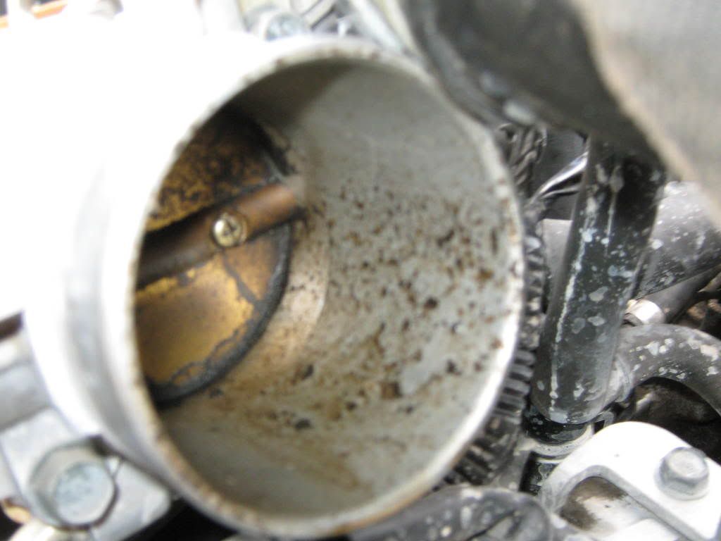

Nice. I need some front Outback struts, as my rear is already lifted about an inch and a half.
I've always said you could pour sand in an EJ22E and it will still run. Case in point.
Hopefully you cleaned that throttle body lol. Poor car, on the positive side SICK!!! Awesome entertainment just you need more video footage ;)

yep, great entertainment. Funny thing is, that the jump that is on video was with the airbox FULL of mud....I noticed it wasnt running quite right, and wouldnt rev to redline in neutral even, indicating a problem....lol.
I cleaned the airbox out (modded it too), cleaned the intake piping, and throttle body thoroughly.

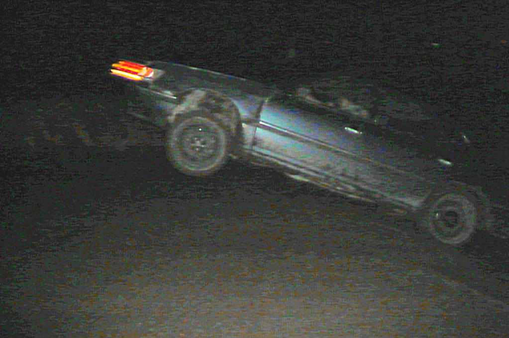

We have hit that jump in a similar manner probably 25 times or more....the last really big jump was at night, and REALLY got it up in the air.....it was high enough that we all had time to yell while in the air, and contemplate the landing for a few seconds. We landed HARD on the drivers front corner, and bent the hell out of the strut, and lost the corner light in the process....lol.

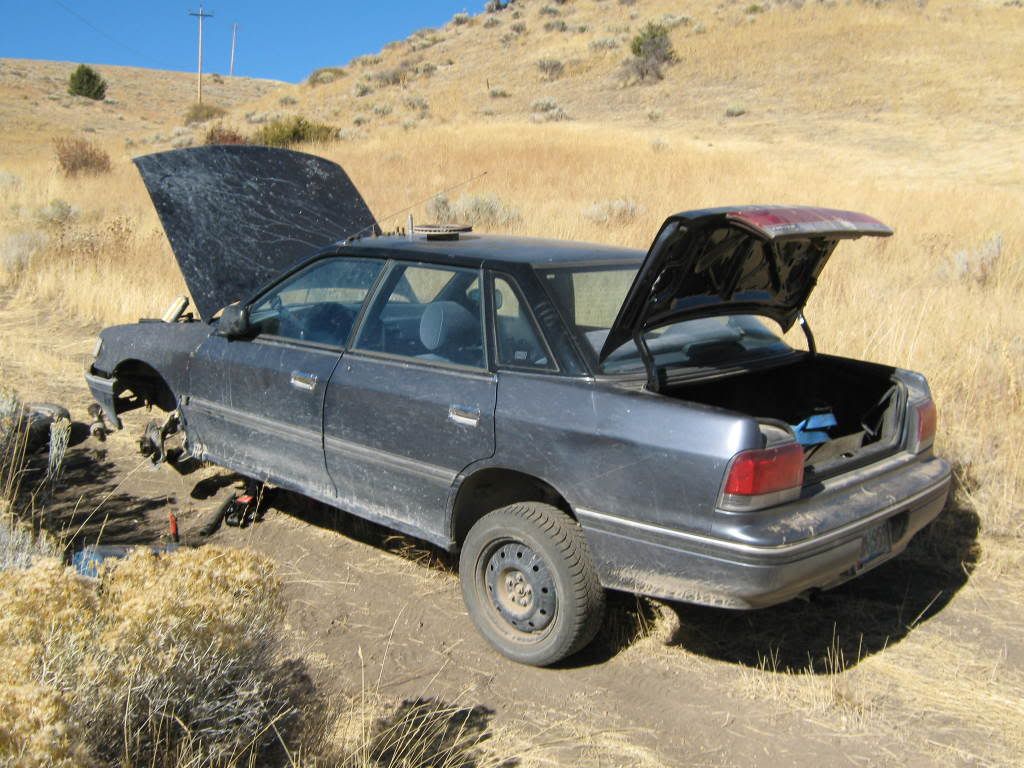

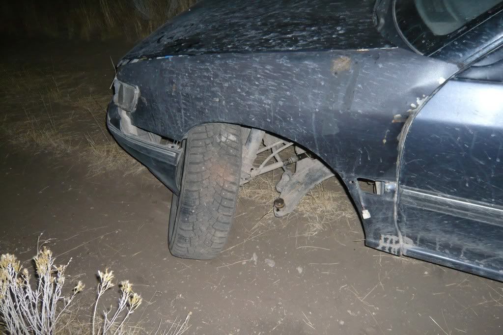

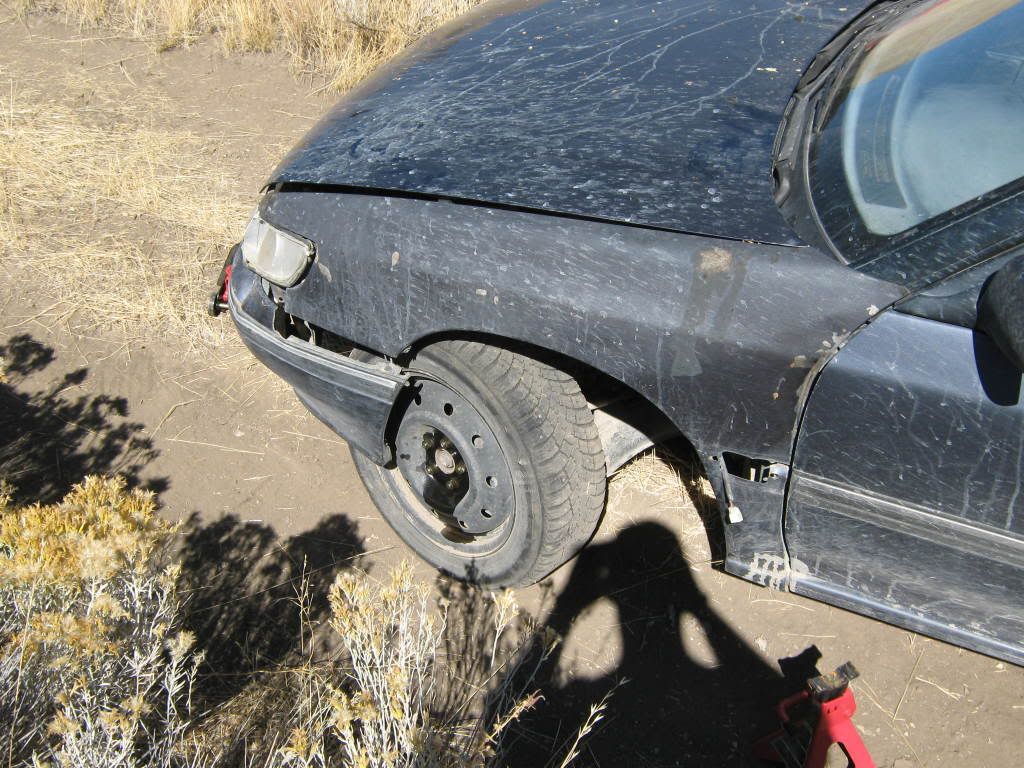

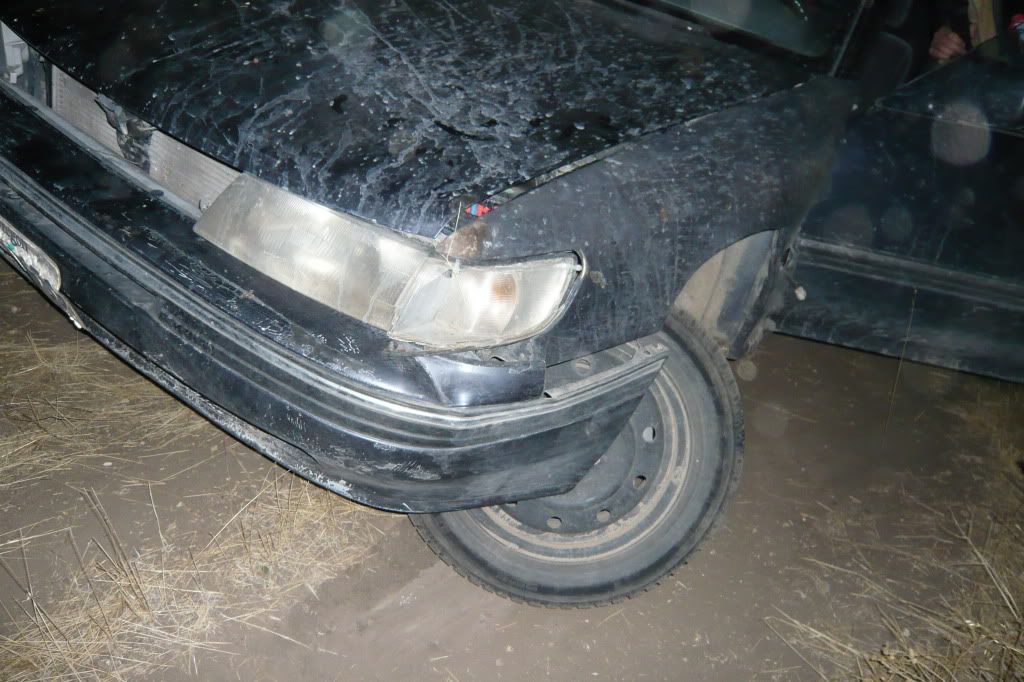

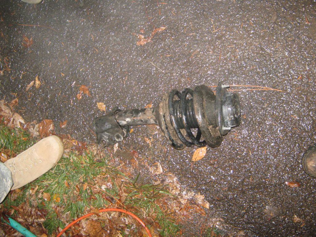

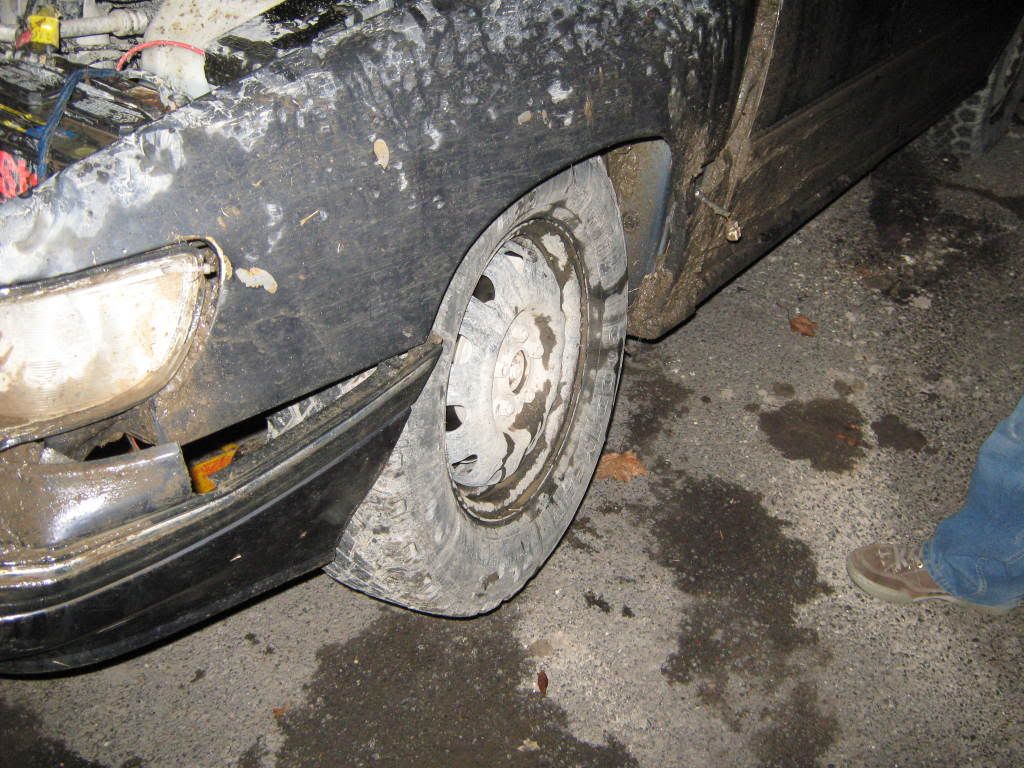

Carnage from jumping, and late night off roading. Broke the pinch bolt that holds the hub onto the lower control arm and ball joint. Had to walk home, and retrieve the bomb the next day. Did a half assed repair to be able to drive home, and repair properly at my house (new axle, and proper installation....lol)
DIfference between the outback and regular legacy struts/springs

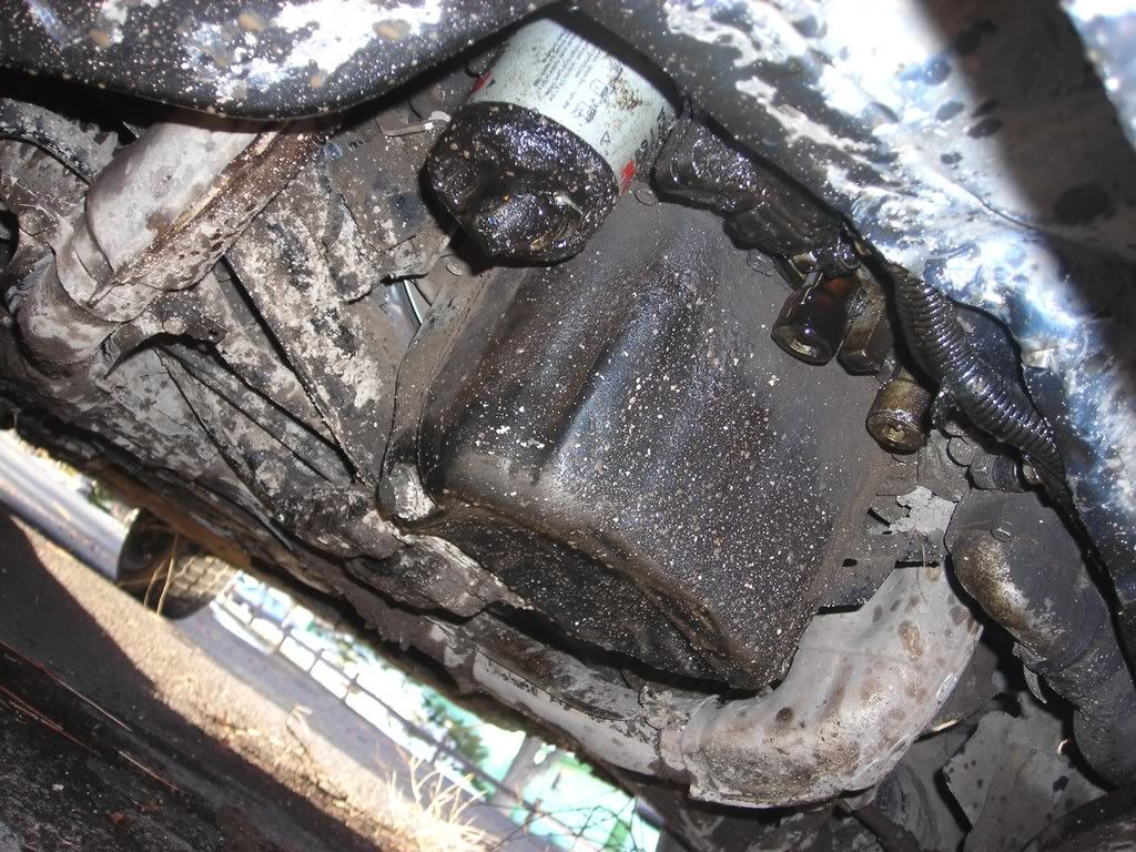

The real damage from this wreck was the oil pump downspouts broke off, and also a tacoed oil filter!

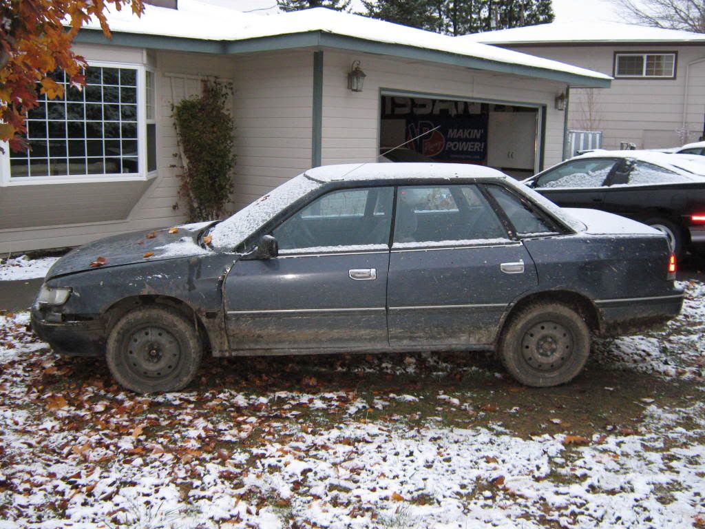

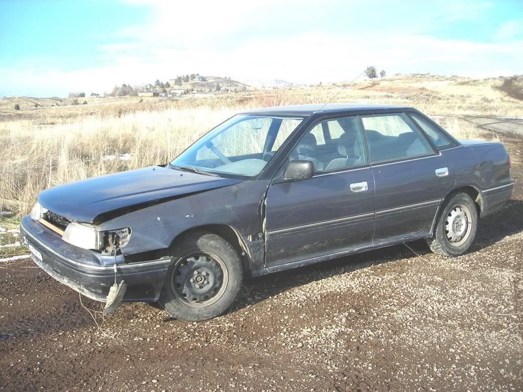

WHen I first got this car...about a year ago.

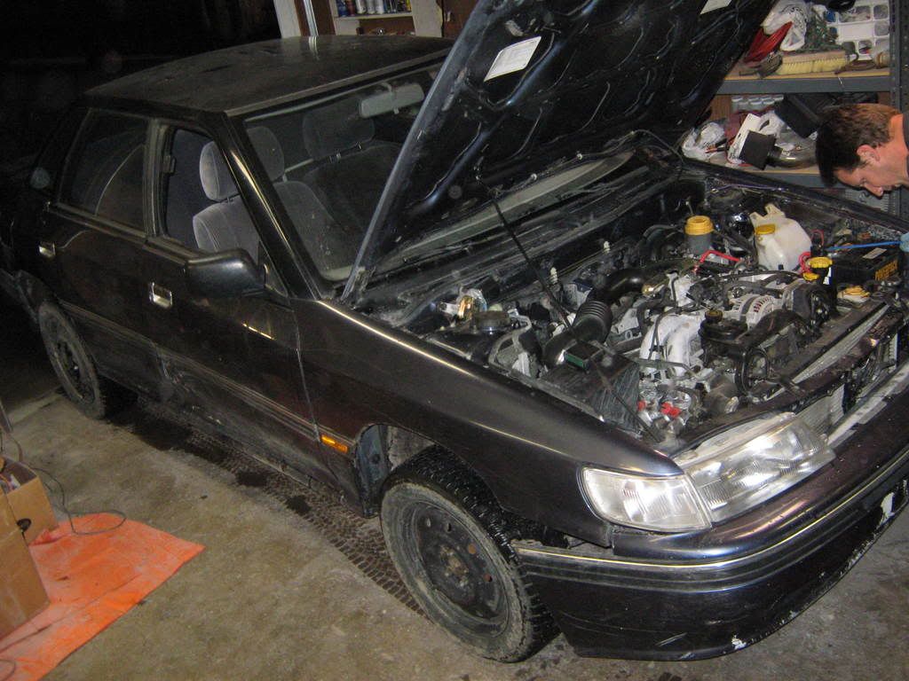

Notice how little it takes to get your Leggy back on the road compared to the DSM's in the driveway.
Sorry, I had to. ;)
