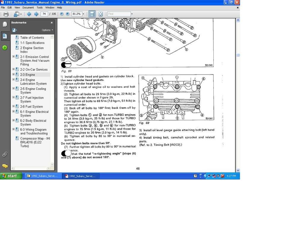

You are using the factory bolts and torquing them 80 ft-lbs? Take a look at the torque sequence and you'll find that it isn't close to that. And it is a goofy sequence due to the torque-to-yield nature of the bolts.

93forestpearl wrote:Image
I appreciate the reference material. I didn't look in my books and was following the directions off of NASIOC from this forum http://forums.nasioc.com/forums/showthr ... ?t=1631471
