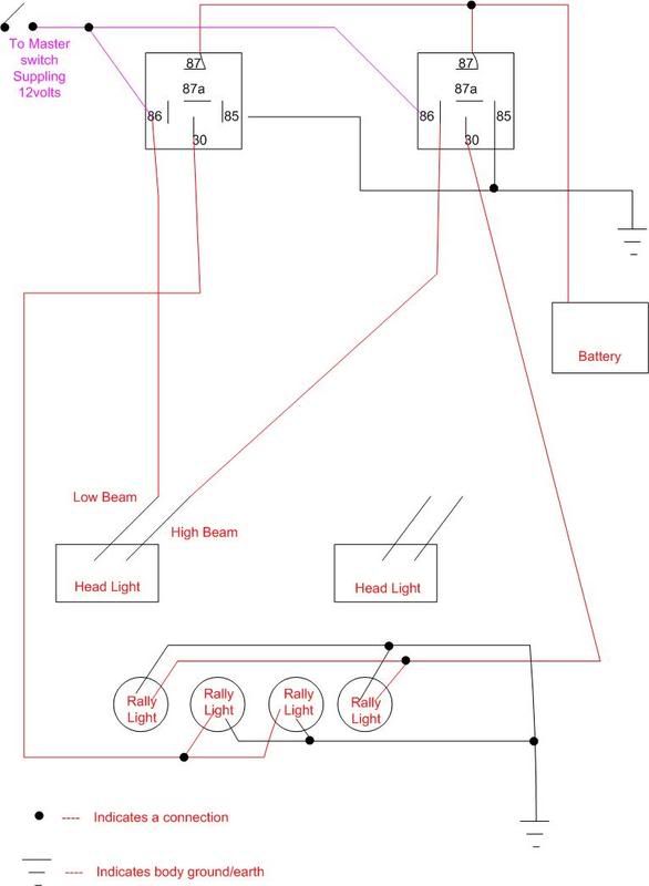

I just picked up 2 sets of Hella 500's that I am going to be mounting on the front of my 93' SS. I was wondering if anyone knew the best way to wire them so that one set come one with the low beams, one set comes on with the high beams (low beam set goes back off), and also have a master over ride so I can turn them all on at once when Legality is not an issue?
thanks in advance for any help!

Here is a quick diagram I just drew up, hope it helps. :)

something is not right there. that shows the light being on anytime the headlights are on regardlessof the switch. I'd do it the same except put the switch on the ground side of both 85's preventing the relays from triggering unless the stitch is enabled. other than that great drawing!

magicmike wrote:something is not right there. that shows the light being on anytime the headlights are on regardless of the switch. I'd do it the same except put the switch on the ground side of both 85's preventing the relays from triggering unless the stitch is enabled. other than that great drawing!
Thanks for chiming in Mike, looking at it now I see what you mean. But, I think to get this circuit to work on a master switch that can disable power to the entire circuit, as well as toggle both lights either on or both off, we would need to add another switch and another relay, something like this??
You are the wiring guru Mike, help us out :)

I think you'll find that the headlights have power to them all the time and they earth through relays when they are turned on. It's a pretty standard way of doing it these days. If that is the case then neither of those circuits will work. Better get a wiring diagram and see how the headlights are wired I think.

Sorry... I should have said... the headlights have power to them all the time the lights are on, then each beam is earthed to turn it on as needed. There is generaly a relay to turn the power on to the bulbs, then two other relays to earth the two beams to make them light up.

ok give this a shot. I took the wire colors out of my hanes manual so I think they are correct.
Description:
Relay 1:
85 - Low current 12V needed
86 - Low current to Switch
87a - not used
87 - High current Fused 12V (Batt)
30 - Connect to 30 on Relay #2
Relay 2
85 - RED from steering column light switch (high beam)
86 - Low current 12V needed
87a - High current output to low beam fogs
87 - High current output to high beam fogs
30 - Connect to 30 on relay #1
Wiring single pole normally open configuration:
This will make the fogs only be able to work if the cars headlights or high beam lights are on.
Terminal 1 - Connect to 86 on realy #1
Terminal 2 - Connect to Blue/Black at switch at column.
To make the lights usable all the time regardless or headlights use a single pole double throw switch and connect the middle pole to ground and the other two to as described above. and illustrated.
hope this helps. Let me know if anyone sees anything wrong with this.
It might look backwards to some of you but subaru wires everything as negative triggers instead of posotive triggers like most american cars. A good way to think about it is that a negative trigger is just a 12v current "waiting" to get grounded.
I don't think any diodes are needed. Let me know if anything strange happens when hooking this up.

Thank you VERY VERY Much! I REALLY appreciate all the work you put into that diagram, I think it's going to be exactly what I need. I'm terrible at figuring out how to wire things (but great at the execution) and I think even I can follow this stuff now.

quick question...so I grasp the concept here, but looking at this, is there going to be a way to have all the lights on at once? Meaning, headlights (in either High or LOW mode) and all 4 hellas?

at the moment, NO, there isn't a way to have all on in this configuration. we can do that but need to add a relay for safety sake. I was thinking about that but you had not specified that in the beginninig... tell me what ou want and i can draw it up... make a wish list if you will...
mine for example are wired directly to the batt and i can turn them on when i please.

Wishlist:
-I'd like them to be able to switch outside set/inside set when the head lights are on w/ the Low.high beam switch like you have it now, but in addition to that, I'd like to be able to have on the headlights and then both sets at one time.
So in essence, there would be a "Road" mode where there was only 4 light on at a time (head lights + 1 set of hellas) and a "Lake/offroad" mode where the head lights + 2 sets of hellas can be on.
I'm assuming "road" mode will still be wired in the same, and the "lake" mode will have it's own seperate wiring with some relays so that part of the wiring is disconnected while in "road" mode....but I'm really not sure how that works...
oh, and P.S, you are a real life saver!
92' SS: SOLD
magicmike
Posts: 2772
Location: USA, RI
Post by magicmike »
ok so let me see, you want the following:
1. headlights work like normal and none of the hellas come on or do anything unless you activate the added switch that I put in.
2. you want the lights ONLY to work when you have your headlights on?
3. It sounds like you don't need the hi beam option.
The problem here is with limited switches. you dont want to put a rotary type switch on your dash do you?
I would suggest, a simple up down switch. Down the hellas do nothing.
Up the driving hellas come on with the headlights and when you selcet the highbeams at the column all 4 lights come on with the highbeams.
What do you think about that?

I could definetly live with the Lowbeams+ 1 set of hellas and highbeams + all hellas.
I started wiring today, But I couldn't figure out the wires under the column. I found the wires coming from the headlight switch, but I only found 1 Solid red wire, and one Blue w/blk striped wire...and they attached to each other through a connector...I are confused...
