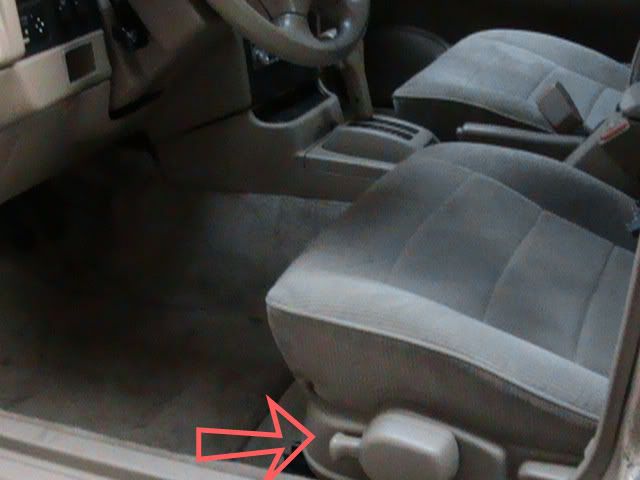

Does the "L" have the height adjuster handle on the drivers seat? Check if it's cranked down all the way.

I have a '90, which should be similar if not identical.
On the track is a 'stopper' that I removed/filed down/drilled out/etc. that gave me an extra 1-2" of legroom...not much but better than nothing and easier than a swap.
I have to force the forward/aft seat adjuster down, as it's now just outside the range of adjustment, but it stays put.
I'm only 5'10", but like my seat all the way back.
