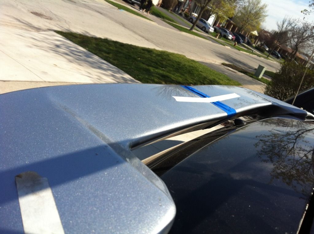

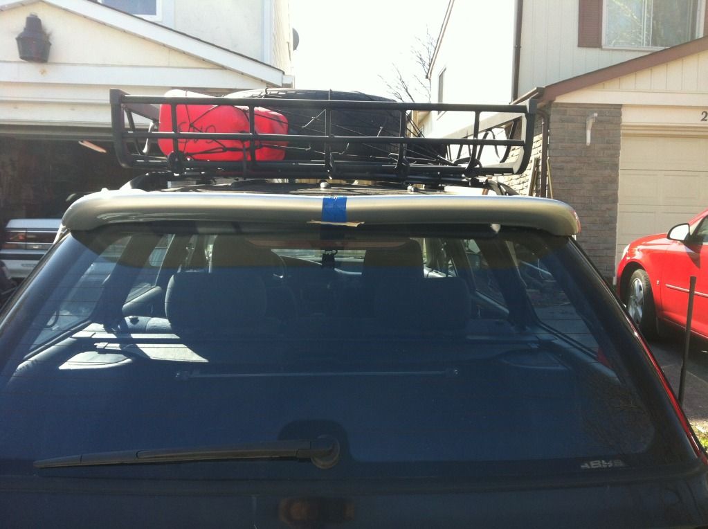

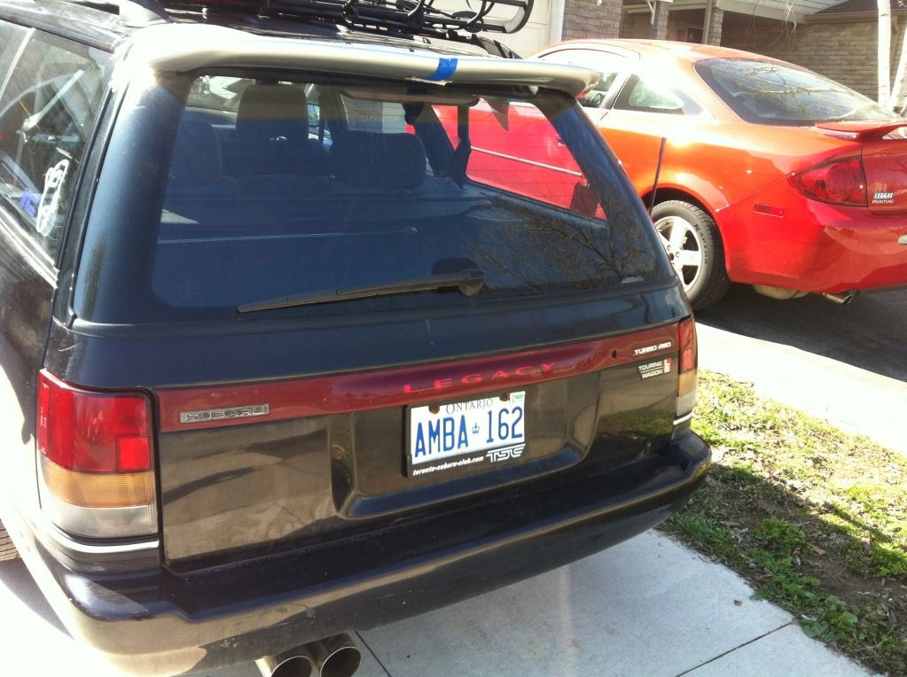

I'm going to cut and test fit the forester spoiler this week weather permitting
as I measured it its about 2" too wide and the profile side needs to be trimmed to match the wagon hatch
here are the first pics from my fitment test

added pics of the test fit after i cut 2" out of the center

Will that hit your basket up there? Looks good
so far dude :D
Now two things:
Where did you get that basket and how much was it?
What kind of rear wiper arm do you have?

i can move the basket forward lol

I have the newer 04+ style plastic wiper arm and I mounted the rear sprayer at the top of the hatch see it in the pics.
As for the roof basket its aluminum and weighs about 20lbs I got it at princess auto its the canadian version of harbor frieght. I paid $150+taxes and its very well made easy to assemble too.

i had to cut like 4" out of my RX300 spoiler to make that fit... make sure when you glue it back together you use metal plates on the inside or it will crack

Oh, I see the sprayer up there. Man, that's cool.

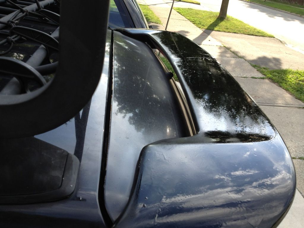

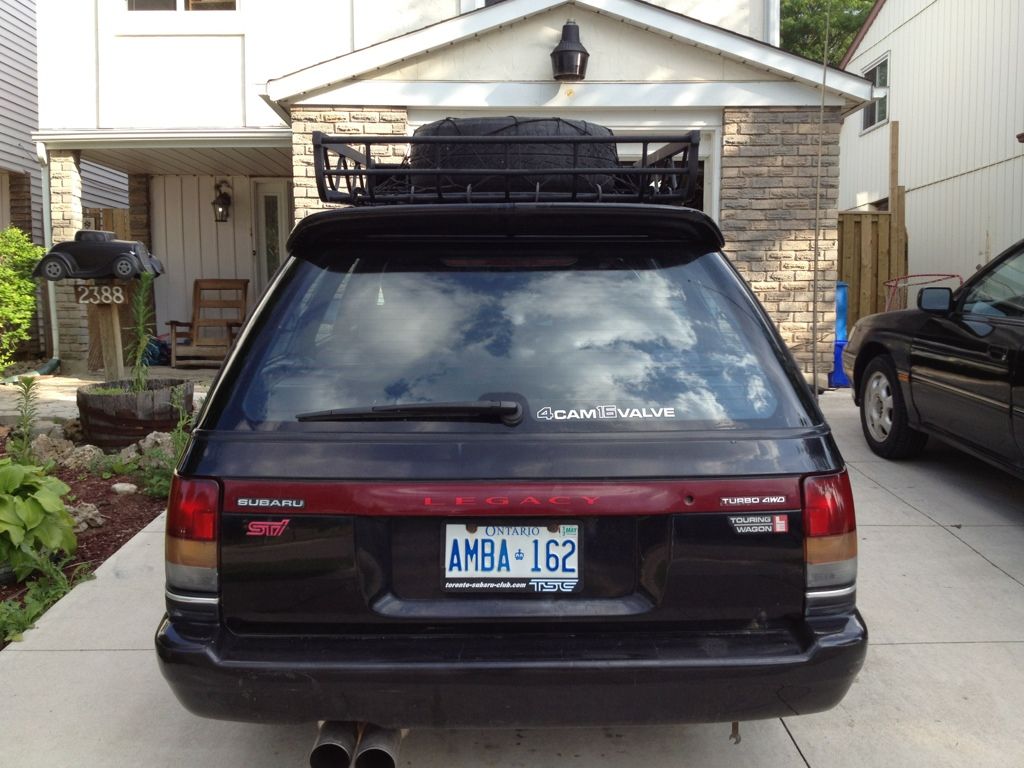

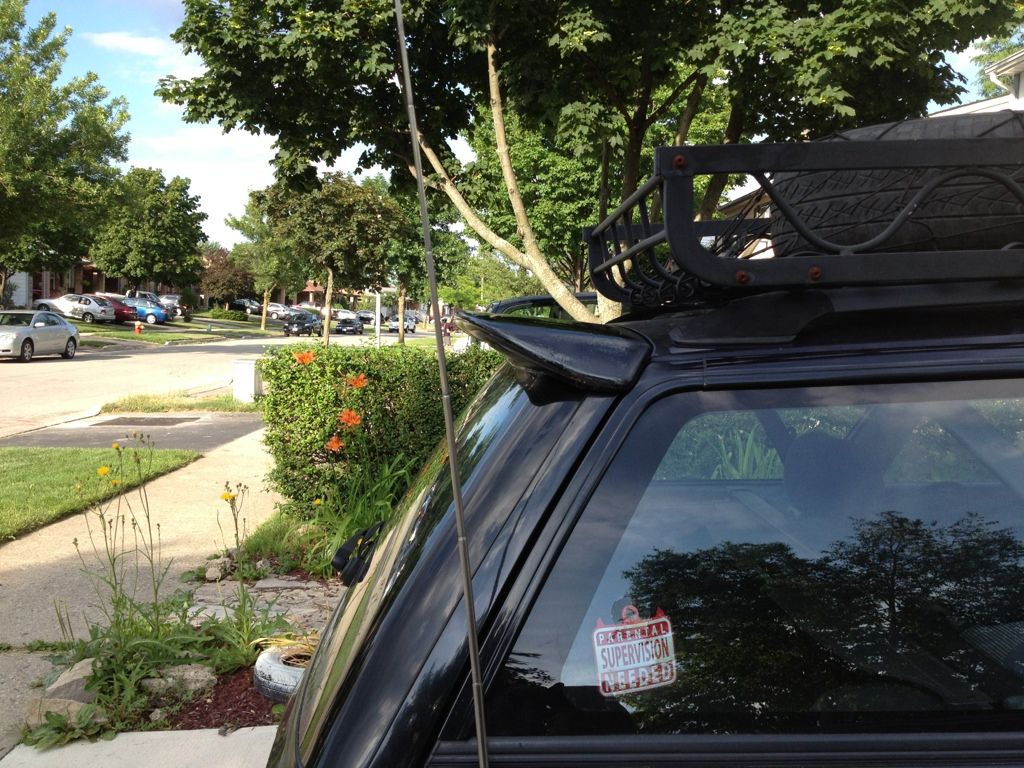

it needs more work but looks pretty decent

Looks like it's meant to be there. Not sure what it's doing functionally with that badass roof rack in front of it, but it looks good.
Re: Forester Spoiler on Legacy Wagon?
Looks sick although the paint looks terrible. :)
