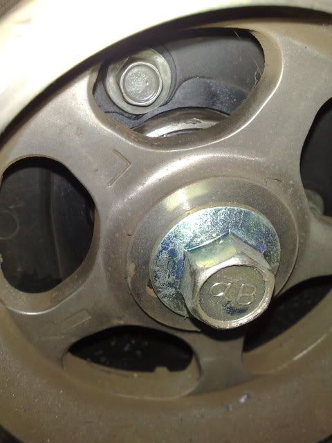

That would be great. Only $200 though eh? That's pretty good. To be honest the leak is not very steady. It is sometimes leaking badly, and sometimes not leaking at all. Going to recheck my hoses.
It is tough to see where the exact source is. The weep hole is up on the inside near the wheel on the pump, and it is probably running right down the front of the water pump, and down the front near the oil pan. The timing covers have seals on the back, and they mount on top of the water pump, so it wouldn't be likely to get coolant inside of there.

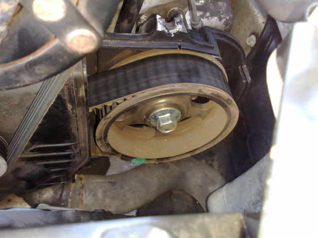

Removed one side of the timing cover. Broke two bolt things in the plastic. Anyway, this is what it looks like under there. Any usual signs if the belt is old or original? I figure the belt if replace is good for 100,000miles. Which is like 160,000km. I figure I can get by with just doing the pump and ill check the torque spec on everything else in there while I am at it.
OK. Finalized the order. Got valve cover gasket kit, and the waterpump with gasket. $145cdn shipped. I will do a overhaul soon if some things don't look good when I remove the other covers. If it looks good, ill push it till around 250,000+ km.
I broke that plastic piece as well, they are pretty brittle.
It looks like a lot of dust inside of the covers, I'd say it hasn't been changed in some time, unless a cover was open to the elements.
I just used motor oil to put the seals in and the o-ring to help slide them in. They fit in there pretty snug, so I used some choice words on the PS and the oil pump seal. The DS cam seal is easy, you can take it out and press it in...I used a C clamp on a bench with a large socket.

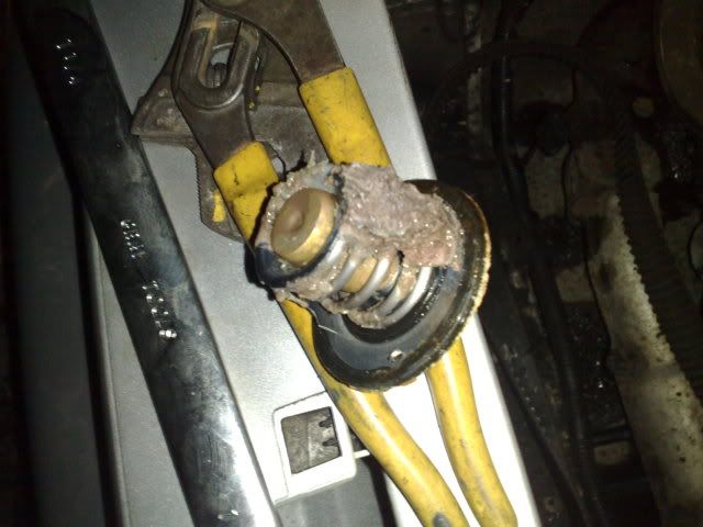

Ok update. Replaced everything. Idlers, belt, pump, rad hoses, valve covers, got my hoses in for the valve covers, thermostat etc etc etc . Cleaned everything particularly the coolant lines. Found out what was going on overheating wise. Alot of parts in the cooling system were clogged. When I pulled the thermostat I said WTF. You will see why when I post the pics. Car is running amazing I found 2 idlers were rough and had play. Was pretty fun first timing belt change.
- Posts: 2385
- Location: 10-9-oh(!), wa
I am thinking the previous owner had stop leak in the car. I flushed out all the lines like mad. Car is driving great. I still smell a bit of a oil leak. I think it was just residual oil on the bottom of the motor burning off. Next going to do all my oils. Tranny, diffs, engine. All synthetic. For the motor 10w-30 I am sure would be fine right? I am right now running non synthetic 5w-30.
