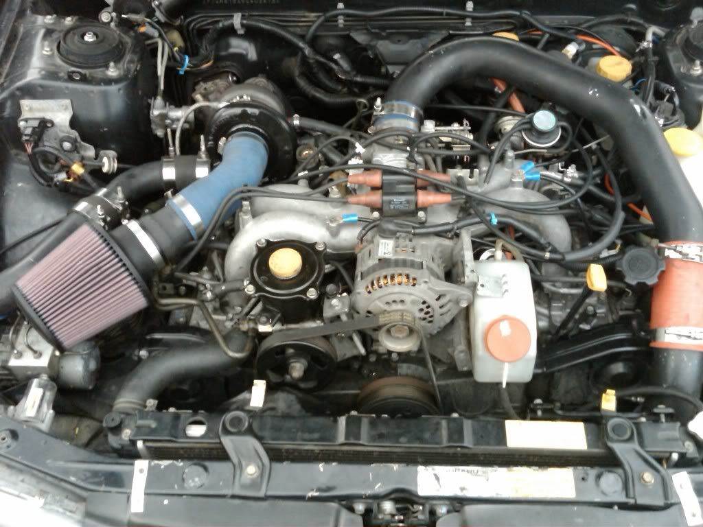

So I spent about 2 days doing this project. most of it was fitment issues and searching for the intake pieces
Ended up having all the intake parts on the shelf
and to end it I picked up some rex wheels
Ill have a clearer picture tomorrow and some more of the piping.
I ditched the snorkle and made my own intake pipe. came out good just waiting for a smalled filter to come in

You sure that i/c is big enough?
Nice work. Do you have a pic of where the piping goes behind the ABS unit?

What car was the kit designed for?

beatersubi wrote: You sure that i/c is big enough?
it looks like it goes thru the factory whole where the air box and everything was

I know its already been asked..
What was the kit made for? non usdm impreza?

The kit looks like a GC8 FMIC kit.
I used the one from CXracing on my SS.

Thanks guy, ill get more pictures up. Been busy with other projects, sneek peek of one
But the IC kit is or says its for a wrx 02-06 I think its junk but I made it work. Its a tad big now but works and will work for the new setup (vf39, pp6, 570cc, aeromotive reg and egual fuel lines)
Im just waiting to pick a vf39 then it will be on

Did you need to modify any of the pipes for it to work?
