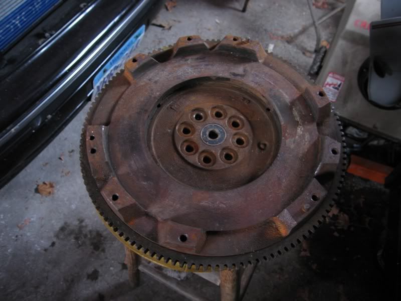

No, you have to use a 6mt clutch. The tranny is a hydraulic pull style, meaning you need to change to a hydraulic pedal box. On that note, the OEM STi clutch didn't slip for me until the 325-350 lb-ft at the wheels.
If your '91 SS was already a 5mt, whouldn't you have a hydraulic setup, unless you changed it?
Also, you need an auto driveshaft for use with the 6mt.
Here is a STi flywheel:
