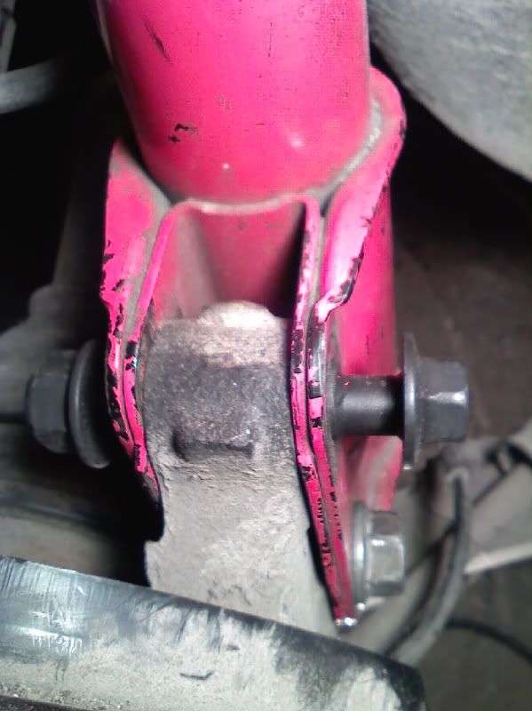

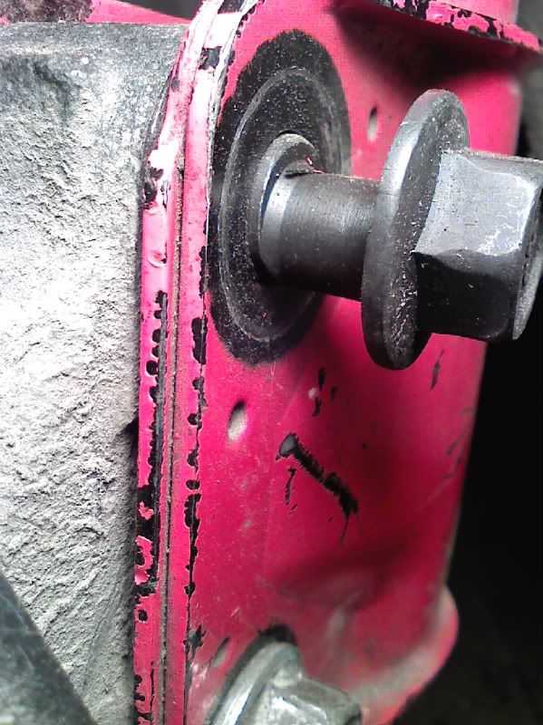

I'm am almost positive they are NOT the same. I believe the top bolts in the front are 19mm and the rears are 14mm or maybe 17mm but I know they're not the same. I got some stock camber bolts from the front of a legacy at the junkyard and tried putting them in the rear struts of my car and that's when I found out that they were too big to fit in the rear holes.
By eccentric, you mean the camber adjustment bolts with the lobe on them? The rears do not even have those bolts. They have regular bolts. There's no camber adjustment in the rear.
I can tell from these pictures that the rear bolts are in fact 17mm and the aftermarket camber bolts for the rear were the 14mm bolts I was thinking about. The fronts are 19mm. The last picture is the stock non adjustable bolt alongside the aftermarket 14mm camber bolt.

All the oem bolts are M14. The front adjustment bolt has a 16.5mm cam. Aftermarket bolts are M12 with a 14mm cam, and a tabbed washer as shown in the pictures to make up the gap between the shaft of the smaller bolt and the hole in the strut.
Yeah you're right. I was talking about the bolt head sizes sorry. I think the bolt threads from the front camber bolt will fit in the rear but the cam Jamal is talking about does not fit into the hole in the rear because the hole isn't made oval like the front to fit the camber bolt.

kimokalihi wrote:
Also, I'm not sure if this picture was taken sometime in the process of installation, but the tab on the washer should only be facing in or out.
