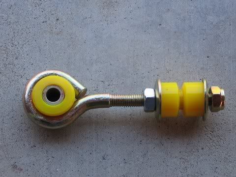

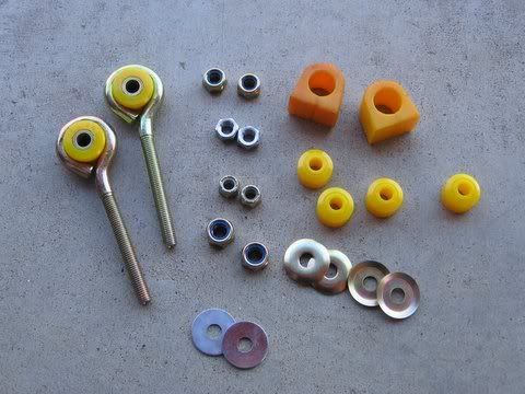

The bar itself is interchangable, but the KIT is not.asc_up wrote:...unless of course someone can confirm that the RSBs for the 91's and 92-94's are interchangeable (that way I could buy the WL 22mm RSB).
The difference between Whiteline BSR17x and BSR19x is the endlinks. The bar is the same but BSR17x, for the earlier cars, includes endlinks which adapt the bar to work with the earlier style lateral links.
Of course you could buy BSR19x, and swap the lateral links to the later style. You'll still have to get endlinks, unless you already have a set of the later C shaped ones.
By the way, I have BSF18 (20mm) on the front and BSR17xz (20mm adjustable) on my SS. It's well worth upgrading both front and rear bars.
Here is the hardware that came with the BSR17xz kit and an assembled endlink.

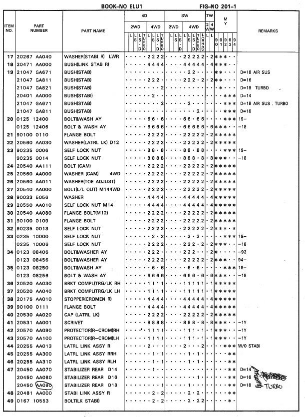

I'll save you the trip. Number 11.
Bottom line is that the stock 90-91 end links will not work with a newer bar. The 90-91 bars had a bushing in the end of the bar, and the end links were U shaped to connect to that bushing.
The later model bar was just metal, and the C type end links connected right to the bar.
