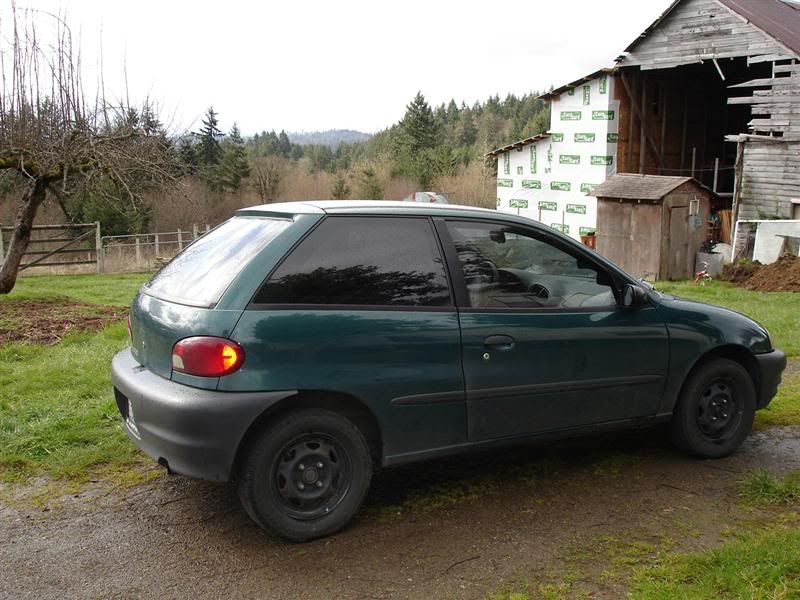

My Metro. Doesn't look too bad.
I'd love to drop it though and get some bigger swaybars. But I need that money for the subaru so it sits tall and has crazy body roll.

BTW it looks like your 98 metro has passenger side A pillar gauge pods--don't tell me it's true.
lol no they're not guage pods. They were speaker pods. I made them to house my midranges and tweeters. Ended up not liking the setup and those speakers so I removed them and bought some new A pillar pieces and I'm going to redo them lower and angled differently with different speakers.
They looked pretty good though.
