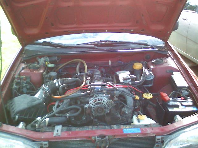

To start off here is the project:
As you can see my Legacy has Impreza body panels. Don't worry, the ej22t was from a totaled 91ss.
I put 40,000 miles on it before retiring it to my parent's back yard where squirrels built a nest in the intake box.
It's hard to see in the camera phone pic, but seriously, a bunch of nuts fell out when I removed the air box.

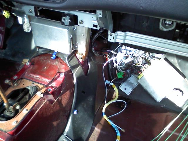

Not much time to work on it today. I was only able to fab up this little panel for gauges and switches.
I will mount the gauges and make another bracket for the eee pc tomorrow. Then i will take apart the engine some more and work on wiring.
