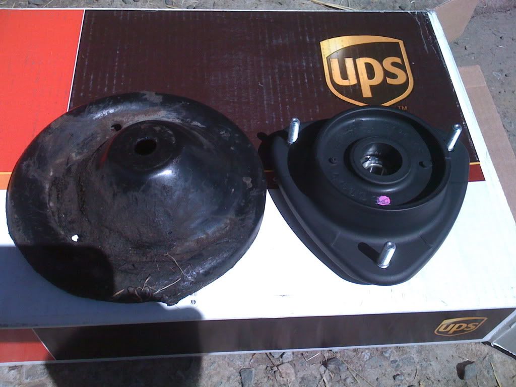

Need some help here guys.
THOUGHT I was ordering the GC equivilent of the piece on the left. what I assumed was called the tophat. Got the piece on the right. what I thought was a Strut mount.
Can someone give me the correct names for the above, and if someone knows off the top of thier head a parts# and where I can order the GC parts I need (the left piece) with overnight shipping?

The piece on the left is the upper spring perch and the piece on the right is the top hat.

asc_up wrote:The piece on the left is the upper spring perch and the piece on the right is the top hat.
The left piece is what keeps the spring attached to the strut. The piece on the right is what bolts to the top of the piece on the left and keeps the strut attached to the car.

So. Borrowed my fathers truck from my sister, who drives it.
Got lucky with the spring seats. First Salvage yard I stopped at had 1 (one) GC imprezza. someone had taken the breaks and half axles out so the struts where just hanging there.
The rest of my day was more interesting. Seems God took the opportunity to torment me. 12 hours later. 3 broken tools. 5 tools borrowed from neighbors and calling it quits twice on account of rain (two inches of standing water in my driveway, no shit) She's back together. New struts, Springs, SS breaklines, on all four corners. though I ended up recycling the strut boots and bump stops as I couldn't figure out the KYB stuff, but the ones i have are in good condition.
Unfortunately When I got to bleeding the breaks, the front break Zirks didn't want to break free and I was far to worn out to continue so she sits in the drive looking sexy, Tomorrow Ill do the breaks, and maybe a photo shoot sunday,
