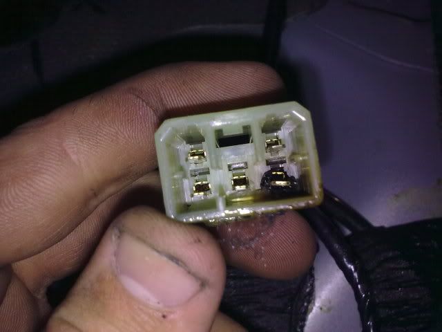

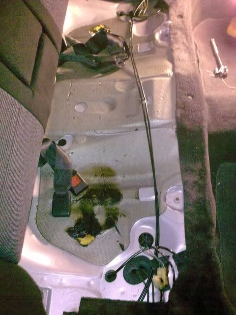

my dad seems to think it might be normal to keep the heat down under the hood. I still believe its odd. Also found something interesting under the rear seat with the fuel pump wiring. Ill post pics later.

I don't believe it is normal. When testing out my scan tool I definitely noticed a pattern of the fan turning off after it brought coolant temperature down below 200 degrees.
The fuel pump connector under the rear seat is a common failure point; the pins that carry the current for the pump eventually corrode a little and make a high-resistance connection that scorches the plastic and eventually fails completely; the previous owner probably just spliced around it or something.

whats with the burn marks on the floor though?
