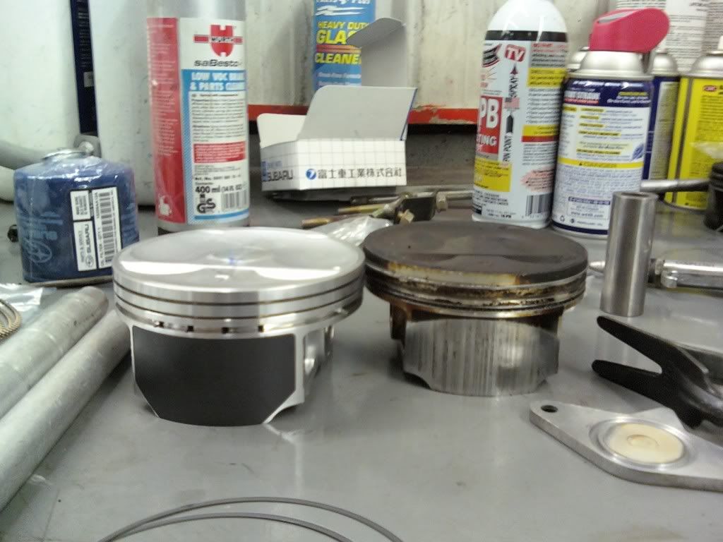

here is what your piston looks like when it slaps for a while:

Damn... Is this a more severe case of the infamous "piston slap," or something a bit more serious (wrist pin troubles)? My wife's '99 impreza makes a hell of a racket until the motor warms up... I tell her not to drive it until its idled for 5 mins or so.

fishbone79 wrote:Damn... Is this a more severe case of the infamous "piston slap," or something a bit more serious (wrist pin troubles)? My wife's '99 impreza makes a hell of a racket until the motor warms up... I tell her not to drive it until its idled for 5 mins or so.
the infamous piston slap.

Thats not a factory piston is it.I know most aftermarket pistons dont ahve the wrist pin offset...related?

gijonas wrote:Thats not a factory piston is it.I know most aftermarket pistons dont ahve the wrist pin offset...related?
both OE parts, just one is smoked.

Wiseco's have offset pins, but I can't speak for other makes.
Piston slap, meh. Welcome to Subaru's. My built motor is quieter than most factory engines. That doesn't mean a slappy motor won't wive you another 100k. I friend of mine's 96 2.2 Legacy has perma-slap on one piston. He beats the thing like it owes him money, and has got him home for a few years.
