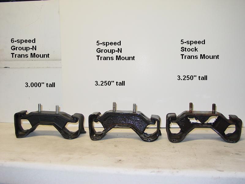

I found this over at nasioc:
Does anyone have the height measurement of the stock transmission mount for our car? Or is it just like the one on the far right in the picture and 3.250" high?
Depending on the stock height, it might be better to get 6-speed mount, since its 0.25" shorter, instead of the 5-speed one I assume most get. Thoughts?

Here's the segment from my build thread comparing the stock 5spd 97 forester tranny mount with the 6spd STI group N mount. Now that the old 91SS tranny is out I can compare all 3 and take pictures and measurements. I'll try to make the most accurate measurements I can.
I'll also try to compare the mounting points of the bolts.
From this picture it looks as though the heigh difference of the 6spd STI group N vs. 97 Forester stock mount is about 1/4" shorter than stock.
I also installed the Group N motor and tranny mounts. I reused the stock mounting plates because they have welded on heat shields and the Group N plates do not. Other than that, they are identical. The holes all line up the same in a straight line and they're the same thickness and everything.
The mounts are significantly stiffer. Particularly the tranny mount, that thing was so soft. I actually measured with a ruler that I was able to bend it about 1 and 3/4" with hand alone. I took a picture to demonstrate with my foot how much it bends. The Group N mount doesn't bend at all. Maybe 1/4" at the most.
The Group N 6speed tranny mount is the one I used. It's almost 1/4" shorter than the 97 Forester mount.
The motor mounts weren't much stiffer though.
Actually after taking a second look at that picture on the bottom it looks as though the stock mount may have a wider bolt hole pattern than the Group N 6spd STI mount....
I dunno, I'll find out tonight.
The bracket to the tranny is what I'm looking at.
Just got done putting my engine and tranny in. There's no exhaust so I can't comment on the clearance with the transmission being 1/4" lower but I'm sure I can work around that if it's a problem.
It does fit though. I have pictures which I'll upload when I'm done eating dinner. It went right in without a hitch.
Confirmed! 6spd Group N Engine AND tranny mounts fit just fine. The bolt patterns and bolt hole patterns are identical. The mounting surfaces are identical. The only things different about the two is the bushing is bigger and of harder material and the height difference with the 6spd Group N being 1/4" shorter.
Also, I checked my stock 91SS tranny mount and it has the same part number as the 97 forester mount so I didn't bother taking pictures of the 91SS since it's the same.
Top - 97 Forester mount (Same part# as my 91SS mount)
Bottom - Group N STI 6spd Mount
Group N mount is aproximately 1/4" shorter.
Bolts are spaced exactly the same distance apart in the same exact locations.
Here you can see it fits right on the crossmember.
Installed in my 91SS with 97 Forester tranny/engine swap. No exhaust yet.
I would say the 6spd mount is not 3.00 inch as pictured above. It's about 2 and 29/32 of an inch.
