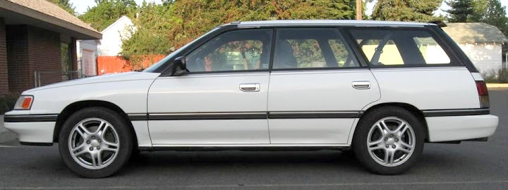

I have '90 BJ, which came stock w/the rear sway.
I put some '06 WRX Wagon struts on a couple months ago for AutoXing....direct swap for the fronts; rears required a 'ghetto' fix by enlarging 2 of the holes.
Tires are 225/50R-16. The outside of the tire just barely rubs @ the rear fender on big bumps.
The front sits a bit higher than the rear. I'm living w/it.
