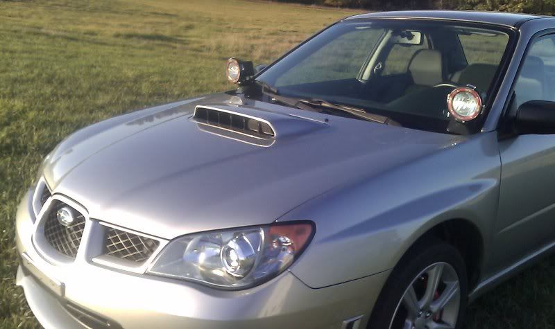

Rally hood lights
Check our these light mouts that I made. they will mount to any near flat surface with industrial tape, no holes in you hood. email me if you have any questions jeepin48@yahoo.com I get about $35.00 a set.
[img][img]http://i77.photobucket.com/albums/j70/jeepin48/pix1.jpg[/img][/img]

DUDE those pods are crazy ! im glad to read that you went with the over kill on sticking them to the hood .
looks crazy ! new paint photos would be sweet .....
also . these stick on lights ... not nearly as cool ! hahaha sorry
