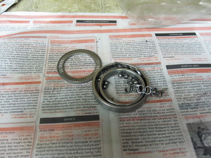

update!
this is what happens when you add the #35 washer when its not called, source of the whine:
Update:
installed a new Center diff..........Without the thrust bearing. mine didnt have the thrust bearing to begin with.
Again did some rotations in a parking lot, and no binding.....
but now i get a whine....?! any idea?

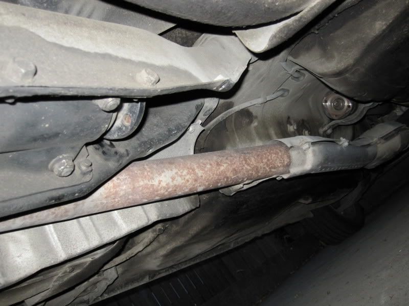

So i picked up this car about a week ago, and i discover new things everyday! while looking at my fuel tank, i removed the exhaust, and and looked up and saw this:
Car runs and pulls great. if i bought the shaft, would there be any issues?
there isnt any wierd sounds or grinding. ive been driving since last week. and i believe the previous owner (a grandma) drove it for 5 years.
guess its time to hit the local junk yard.

I doubt it just fell off, and I doubt granny took it off, so I'd wager there's a reason it's off. So I'd expect to find something else that's need to be replaced on the rear side of the drivetrain.

unless ujoints were bad. If something in the rear diff was bad, it would be apparent by driving..

Buffman wrote:unless ujoints were bad. If something in the rear diff was bad, it would be apparent by driving..
Yeah I was thinking that too. All else fails, find a cheap replacement shaft and see what happens.

yeah, i hope thats just it.....install a replacement shaft, and its good to go... :?
hope the rear diff isnt toast, i dont feel anything wierd or any vibrations. wish me luck!
Wouldn't this mean the center diff is likely toast from always transferring power to the front?

I'm having trouble imagining a mechanical scenario where removing the rear driveshaft would be beneficial to an MT drivetrain (barring anything seriously wrong with the rear end)... Maybe it was towed on a dolly at some point and someone neglected to replace the missing driveshaft?
I'd just replace it and listen closely for strange whining or anything like that from the rear end or tranny for a couple hundred miles. The center diff is pretty robust, I'll bet it's fine.
One other thought, are you sure it was a grandma who owned it the whole time? Any chance this is a botched AT--> MT swap with the wrong gearing and someone didn't replace the rear diff? What does the final drive on the rear diff say (should be written right on it), and what is the TY # on the tranny? Such a scenario is not at all unheard of...

Yep im pretty sure....the last owner grandma had it for 5 years. i read the title so i know she was the owner.
yeah, swap is unlikely....looks too clean....
rear diff number, im trying to remember off of the top of my head, like 3.9 something..
thanks for your guys's help. if it doesnt work out, i just ill keep it a fwd car...ftl

95 should work on that, make sure it's an MT shaft though. The front half of the AT shaft is a different length.
