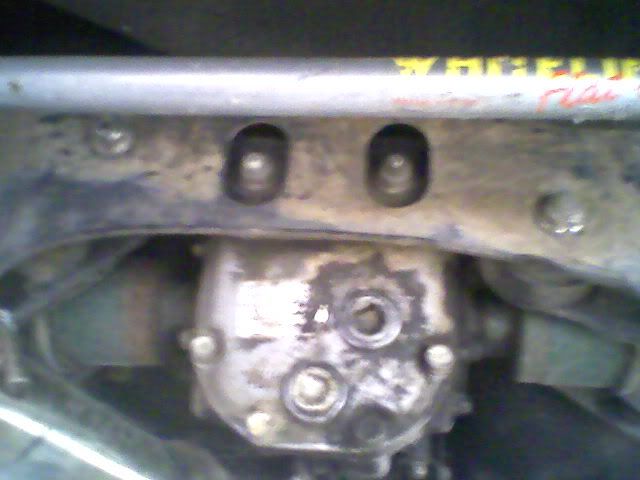

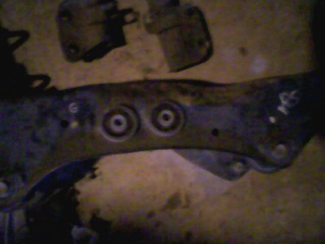

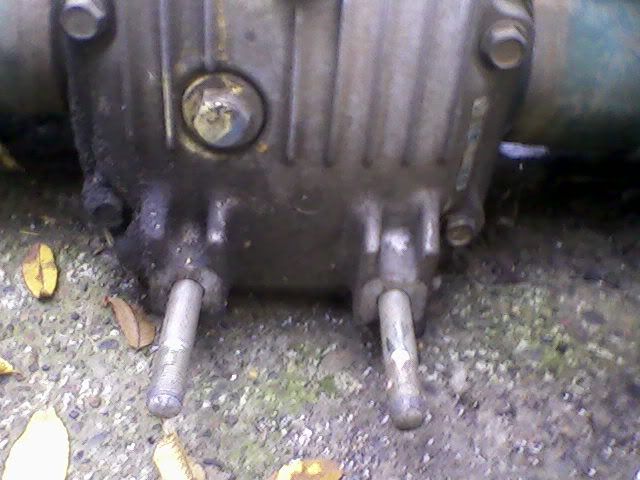

As he said it will bolt up, but you will have to use the 97 rear diff. Because the x-member is set up a little different for mounting. I could be wrong but i vaguely remember hearing you could swap the mounting studs to get your diff to work. All go take pictures really quick.Legacy777 wrote:It should. I think there may be a difference in the rear diff mount setup, but that shouldn't really matter.

Style 1: The bushings are not part of the x-member.
Style 2: As you can see the bushings are in the x-member.
Older style: The studs are short compared to the later years.
Newer style: As you can see the studs are longer then the earlier style.
I apologize for the crappy pictures. They came off my phone.

^ Very useful info! One thing to add, not only are the studs longer, but the design of the diff cover is also different. I make it a point to match the diff cover up to the crossmember in the car. Some more pic pleasure from my adventures. The shorter studs are from a 91 Legacy diff with the bushings NOT integrated into the xmember:
