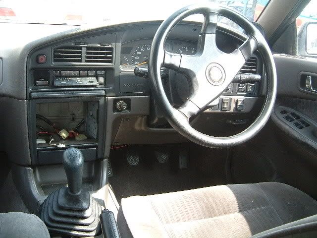

Has anyone ever seen a pic of one? or does anyone have an alpine edition and will take a pick of theres for me. Looking to add one to the t-leg and need a referance for browsing ebay. also is it just a plug and play part IE no other parts needed?

I've got auto climate control in a '90 (editted, thanks) LS wagon parts car. It is NOT plug and play, my understanding is that you have to have the entire heating/cooling system to swap in. I've looked at it nad the controls are vacumn operated instead of cables, so that's beliveable.
I may be able to get pic's Wednesday afternoon, depending on whether I can see the dash or not... Lots of parts crammed into the car...

Trust me, it is not going to work, even after swapping everything in. The wiring harness is completely different also.
Most of us have contemplated it, but have given up due to it being a lost cause.

I hate to say this, but SHOULD is not the way it works.
The mirror wiring for heating is not there.
Same thing with the auto climate. It was a different harness altogether. I have an 05 STI with the auto climate. I have an 01 RS and have seen and had the controls for the auto climate. Same thing with the SS. It is WAY different that the set-up for the stock manual controls.
It is not worth the effort to just have it be auto on the SS.

ok auto climate WAS an option for LHD cars which still could have been outside usdm I guess.
http://bbs.legacycentral.org/viewtopic.php?t=30531
see fig 720-4a There are some harnesses that may match up somewhere as well. Also 730-1 shows a diferent heater system altogether.
I think I stand corrected on the mirrors and seats being heated as they are not in the catalog. I guess it's possible the Alpine editions where ethier full on imported jdm shells or where imported harnesses and parts from jdm.
Now weather or not its a usdm thing I'm not 100% still
tahiti350

My '91 is LHD, and the Auto climate unit doesn't look anything like the one pictured above. here's a pic of it

ericem wrote:So maybe there is two auto climate units and one type works!
There ARE at least two types, that is certain. I've seen both kinds in various pics. I have no idea of any other details--such as where and when each type was installed. Pre- and post-facelift maybe?
It's a nice unit thats for sure.
Posts: 27943
The one in the pic above is the ones found on the europeon & possibly japanese models.
I don't think they were a full auto climate control like the ones found on the higher end legacies here in the states.
