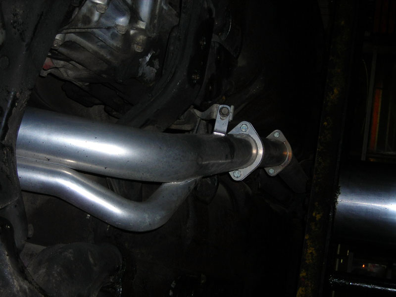

First of all I need to amend my above post. It was indeed the Flowmaster that I was remembering, not the Magnaflow.Legacy Konig wrote:this CES you guys are talking about, is this the Austrailian company that I know of? Do they sell through U.S. retailers?
And yes the CES stands for Custom Exhaust Systems which is a company in Australia.
3 years ago when I bought mine they had NO retailers in North America. I haven't checked but I don't expect this would have changed since then.
I consider my CES exhaust to be worth more than my complete engine.

First off Dynamic Entry, those are some very nice pictures of your exhaust. Very nice set up. It's not that money's too tight, I just don't know if I could afford a complete cat-back setup. So I was thinking just delete the resonator and run the piping from that flange back.

Here's some more pics of the CES exhaust
http://main.experiencetherave.com/subar ... s/ej22t/25

Dang 777, that is a nicely put together setup. Hand-crafted by the Australians lol, they've got Whiteline and CES, they're doing something right.
