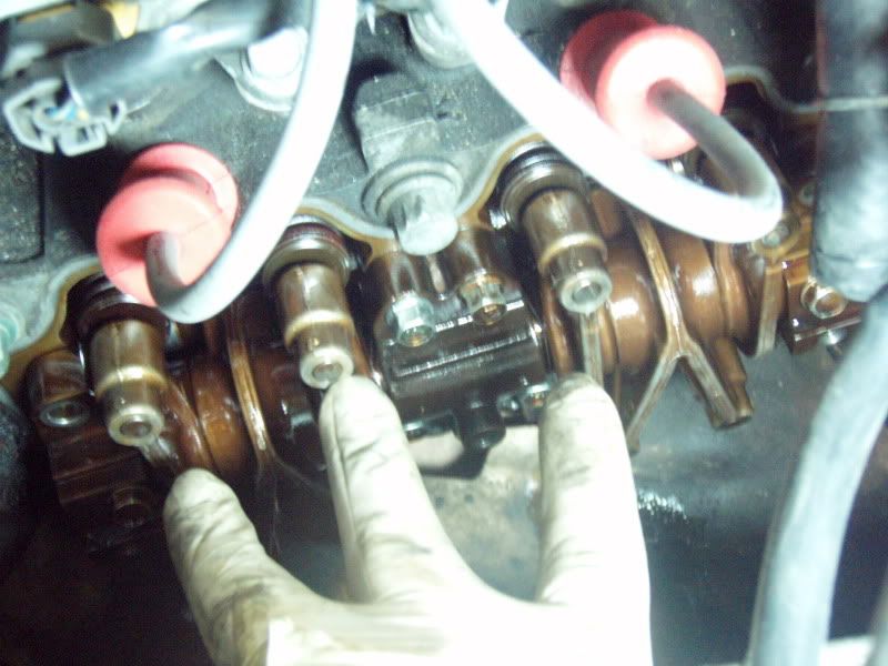

Ok so my HLA's keep going soft. Its the "top" ones on the passander side bank. I've blead them and reinstalled three separate times!! Every time, the rattle comes back in like a week. This last time, it came back within 2 days. :x Oh and i replaced all the HLA's last time around with "new" ones from a donor car. Still, same problem. What its going on? I hate the stupid noise, its embarrassing. Any help would be appreciated.

Florin1
Posts: 1173
Location: Lynnwood, Wa.
Post by Florin1 »
oh yeah i've done that like 4 times. That was just a picture to show which "top" hla's keep going bad. Its the top row for some reason. Don't matter which ones i swap around, after i bleed them, the top row goes flat again in a few days.

disassemble entire shaft unit. You might be surprised if you find some piece of debri clogging the tiny hold that feeds the hollow shaft. That was my issue. It would do it now and then, and one day it wouldn't stop. I bought two, thinking only two could be bad. All but two were bad. Got more and even the two new ones went soft. took whole shaft apart..
Found rock/debri, clogging hole, got it out, and they're golden now :)
One 10mm bolt on each end holds the end caps on.
I had a picture, but can't find it now. The hole that was blocked on mine was the end cap side that had the feed hole, it's in a rectangle cut , half way in the middle.

done that the very first time i bled them, but i did not really look in the shaft to look for debris. Should i shoot brake clean through the shaft? I'm afraid of breaking down the oil in the shaft, unless you don't think that will matter.
(side note, my Little sister was walking by and noticed the picture ^ and says "what is that? It looks like chocolate bears marching" :lol: I had to share. (she is 17)
1994 Legacy Sport Sedan.
