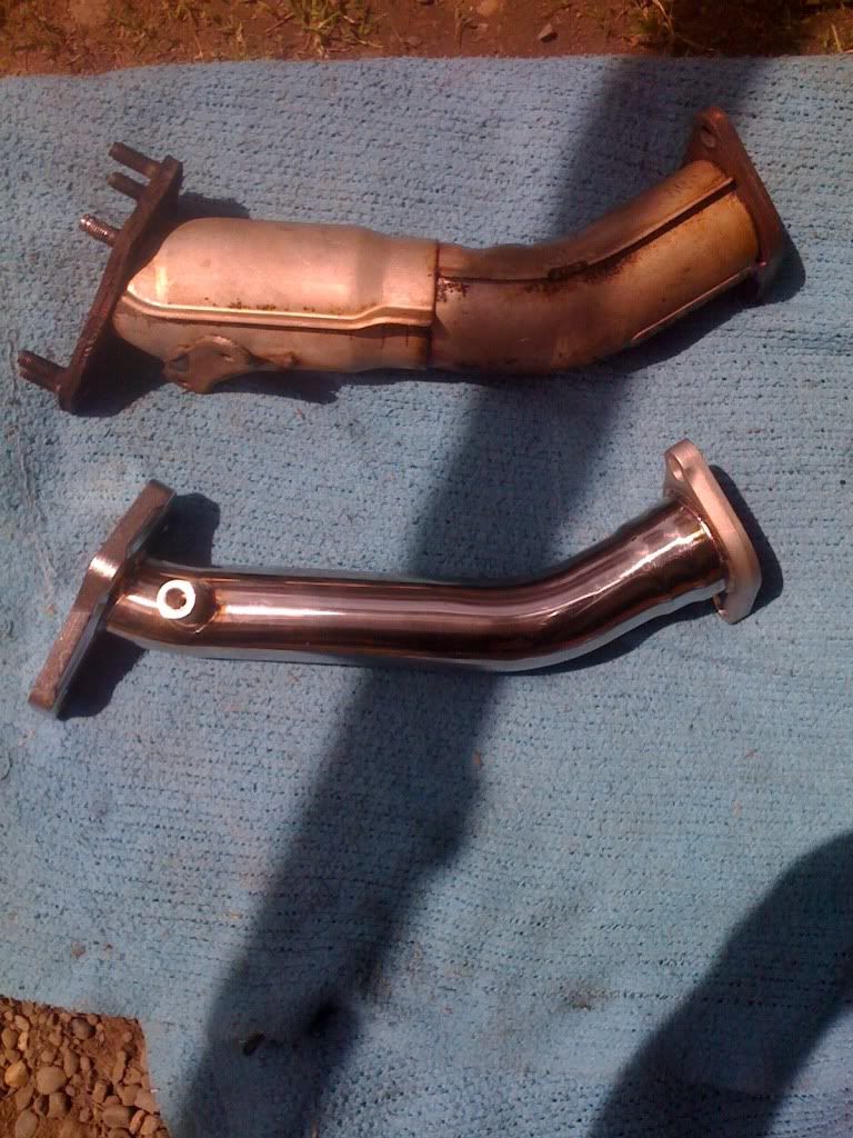

ended up using an invidia sti uppipe/Cat delete. Put it in this morning. fit was perfect!
Re: up pipe removal.
did you plug the hole or use it for a gauge.
I plugged it with an allen head set screw. Thought it faces "out" away from the engine so is easy to get to should I decide to use it for something else.
