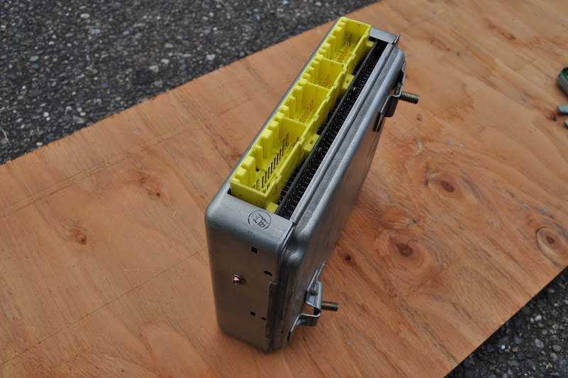

----- MOUNTING ------
The mounting between the two ECUS is quite difference. What I did to make it fit is basically use the top half of the EJ20G case and the bottom half of the EJ22T case and fit them together.
Here is the stock EJ20G ECU;
Remove the six screws from the side. These are fairly soft material and threadlocked in. Its very easy to strip out if you do not use the proper size phillips head. If they do strip, then it's out with the vise grips!
Once off you have access to the ECU board.
Remove the two screws that hold the ECU down to the bottom half of the case. Then put the board back in the top half and use the two matching screw locations to reattach to the case.
Lastly, take the bottom half of the EJ22t has ears on either side that can be fitted around the edges of the top half. This provides a pretty snug fit. I wasn't so thrilled that the ECU board wasn't as secure and possible susceptible to vibration, so I jammed a bunch of bubble wrap between the bottom of the board and the bottom half of the case. Sounds ghetto, but it works the treat! Lastly to make sure the two halves didn't want to pop apart I put a little duct tape around the seam.
Viola!
